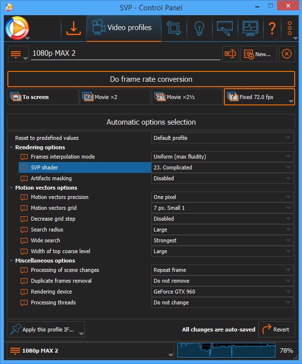

I don't say there is no improvement and perfomance,, just in very fast scenes it looks like does not do anything and overall motion is like little blurry (like on games Motion Blur=ON) and in a very few scenes the actor still a little at 24fps (does not happening at 4.1 with same settings)
SVP 4.3 Settings (Image)
settings 2.jpg, 73.57 kb, 594 x 359

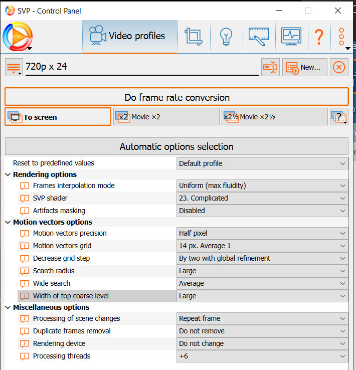

Everything is at max value, which shouldn't be the case to get smoothness. I find motion vectors grid at 16 / 24 / 28 works well.
Try reducing some of the other settings as well, especially MadVR.
Screenshot_32.png, 64.51 kb, 710 x 738

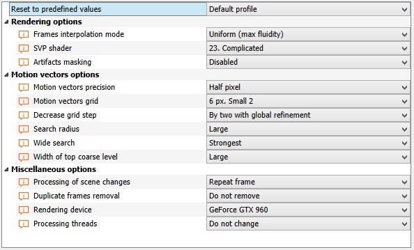

And with my hardware I don't think I can run your settings. You're maxing out everything like @AutumQueen92 is saying. With your hardware this is impossible. Also even if you HAD the best hardware, this settings is not good in my opinion.
This whole time you have probably been watching with a lot of delayed frames and a lot of dropped frames. Of course it's not going to be smooth.
Here are my settings below, test them out, and disable artifact masking if you want a smoother experience:
https://i.imgur.com/4vReGUI.png
6 (edited by KnightRiderKARR 03-05-2020 14:07:11)
Re: SVP 4 not much smooth in some scenes
I try your settings but is not good smooth for me...
I think they change scripts/development at motion vectors precision and grid + the bad is only 1 option artifacts masking are available (with 3.0.6 had 3 options {Contour and 2 bad areas suppresion})
I dont know if we can get motion vectors grid at 4px (maybe it helping me) and offcourse i know i will have more artifacts but i dont care -- with SVP 3.0.6 i had more "soap opera" and more options
Βy choosing "SVP Shader = 21.Simple" i see the motion blur has been little decreased
@Blackfyre and @AutumQueen92 i dont have fps drops or delayed - at 720p with max settings run fine - Only at 1080p i need change 3 options (See Image for proof)
SVP 1080p.jpg, 131.28 kb, 615 x 739
