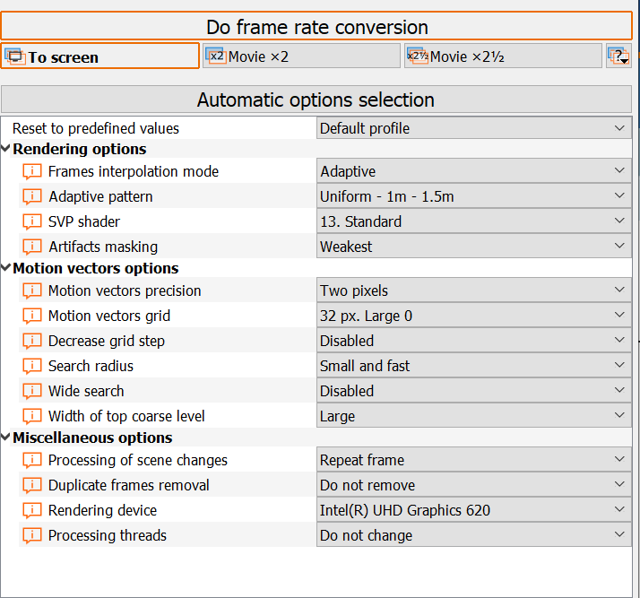

I'm trying to find the most performant settings, because my integrated gpu is really bad (UHD 620).
I've uploaded my current Settings as an attachment.
What can I do to make it even lower?
Also, which upsaling filter on mpv is recommended?
Thank you!
Anmerkung 2019-10-07 223312.png, 49.63 kb, 714 x 667

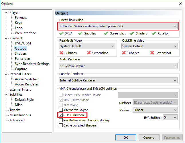

I recommend to use EVR (custom presenter) with D3D Fullscreen option enabled on IGP.
Select Resizer: Bilinear.

I should have mentioned, my processor also isn't really good (a laptop version of the Intel core i5), so using the minimum svp Settings would help, I think.
I'm also interested, which motion vector grid and which "widht of top coarce level" gives the best performance?
