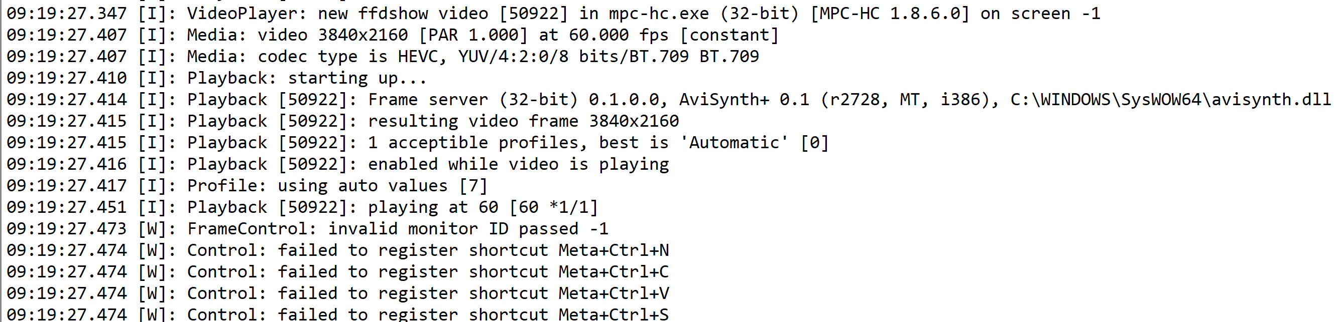

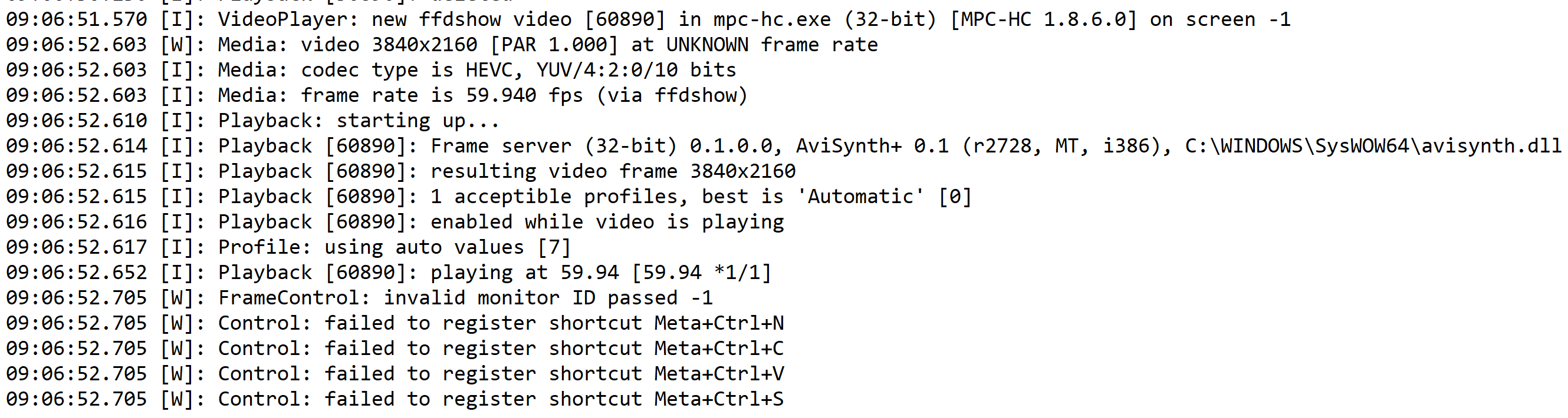

3 (edited by panzerjeffrey 23-05-2019 13:21:22)
Re: Frame doubling and lag - 4k60 source HEVC (x265) .ts
This is what I get.
SVP recognizes the 60fps with the MKV but not with the TS
