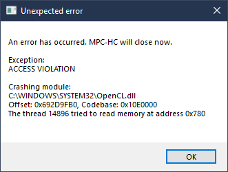

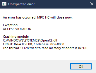

I've had this error for quite a while, but now it seems I start to get it more and more, randomly, sometimes when playing a video, sometimes when the next file in queue starts, but the most common case is when I skip a few seconds from a video. There is nothing in SVP logs that seems out of place, and I've tried to use MPC-HC without SVP and the error seems to not appear.
Bellow are some images with the error. Even though the error appears, the sound continues to be heard until I press ok.
Would reinstalling the video drivers with DDU solve anything or no?

It seems that DDU has solved the issues, and also made SVP faster, even though the drivers aren't the newest ones.
