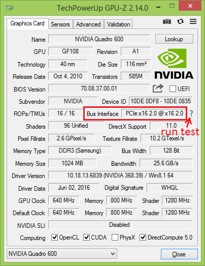

Looks like you have slow speed between GPU and CPU (RAM). It depends on PCI-e mode. It must be x8 or x16.
Check please.
GPU-Z_PCIe_speed.png, 29.99 kb, 404 x 523
Check please.
Hello, sorry for the delay to respond. I checked it and it's exactly like in your image, x16 2.0.

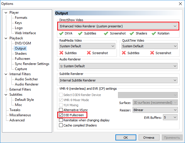

Maybe you have madvr enabled and it asks very much performance from GPU.
Try to select EVR Custom with D3D Fullscreen. MPC-HC menu View - Options... - Output tab
Is it help you?
Is it help you?
Unfortunately no, I tried this now and it remains unusable the "High frame rate index" goes crazy 0.3 ~ 2.5, and with many stutterings in the middle of it. One thing I noticed is that when I open a video the processor usage rate is 80 ~ 90%, this with the gpu acceleration on, while the gpu does not reach 30%, after the stutterings begin to use cpu drops to less than 10% but the GPU also almost 0%.
