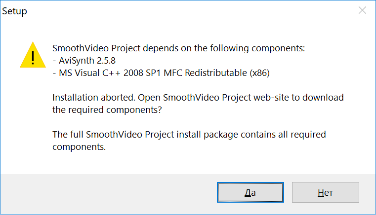

I've tried to install SVP 3.1.7 core just now. It asks me for VC++ 2008 not 2013
SVP_3.1.7_installation_stop.png, 15.19 kb, 761 x 436
