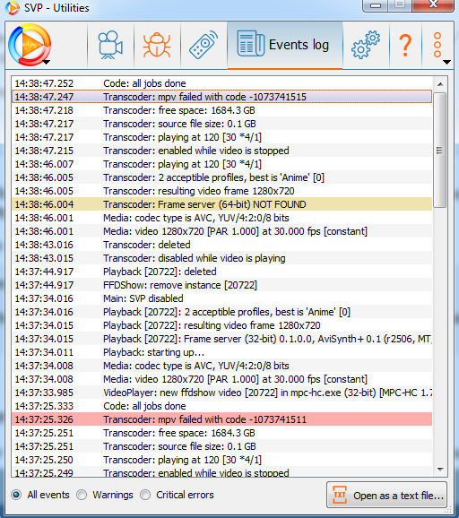

1: Here is a screenshot of the events log that I have just taken.
2: I have just re-installed the 64-bit version of VC++2015 Runtime, as per your link/instruction.
svp.png, 68.42 kb, 512 x 578
Re: Updated SVP And Now Nothing Works
SVP is disabled because transcoding is not finished - you need to press a button in transcoder window.

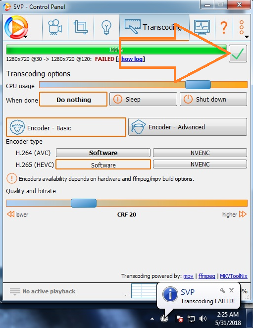

You say I need to press a button in the transcoder window?
Here is a screenshot of what I see, whenever I hit the START button.
(My apologies for the late response)
button.png, 344.18 kb, 511 x 662

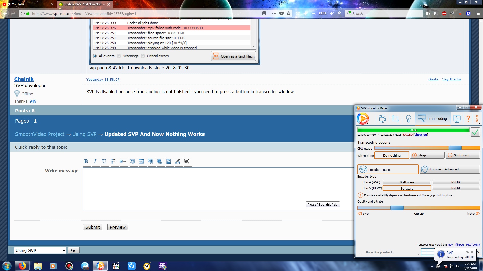

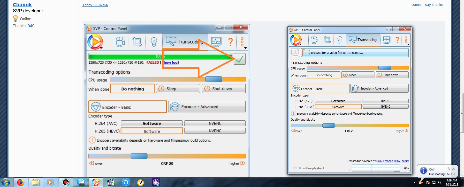

OK I clicked on that green check mark, and it simply went back to where it asks me to load a file.
Man, do you see the SVP icon is gray? Do you see the line "SVP is disabled" in the log?

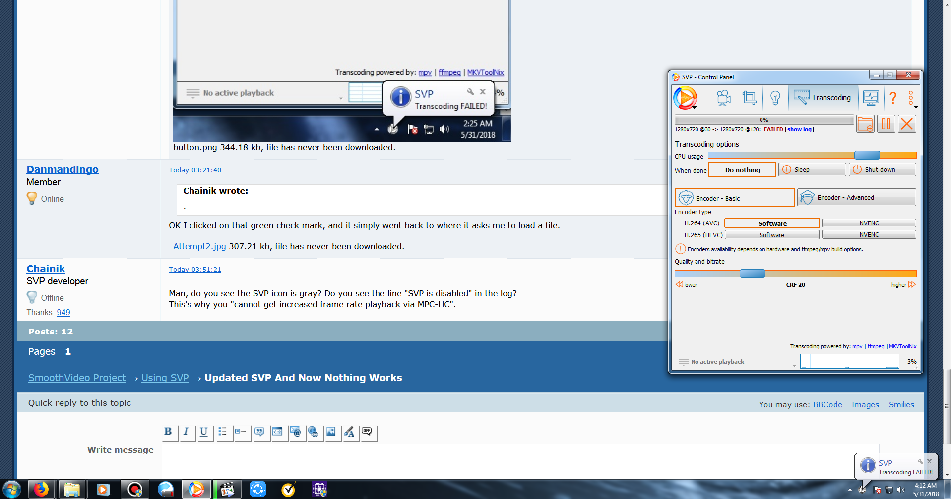

Yes I see it. And I'm sorry if this problem is annoying. Believe me, it's troubling & puzzling to me at the same time.
The icon will be gray, until I click the green check mark.
Once I hit it, the icons color fills in, allowing me to use MPC-HC with the settings I've created. (Thank you for that). But if I try to use the transcoder, the icon goes gray again.
It just stays at 0%
SVP is disabled while transcoding is running. This's by design.
I can't tell why mpv.exe gives "The procedure entry point  ucrtbase.terminate could not be located in the dynamic link library api-ms-win-runtime-l1-1-0.dll" error for you. "api-ms-win-runtime-l1-1-0.dll" is a part of VC++ runtime, which indicates something is broken in your system, and it's NOT SVP's fault. You probably need to update your system via Windows Update.
