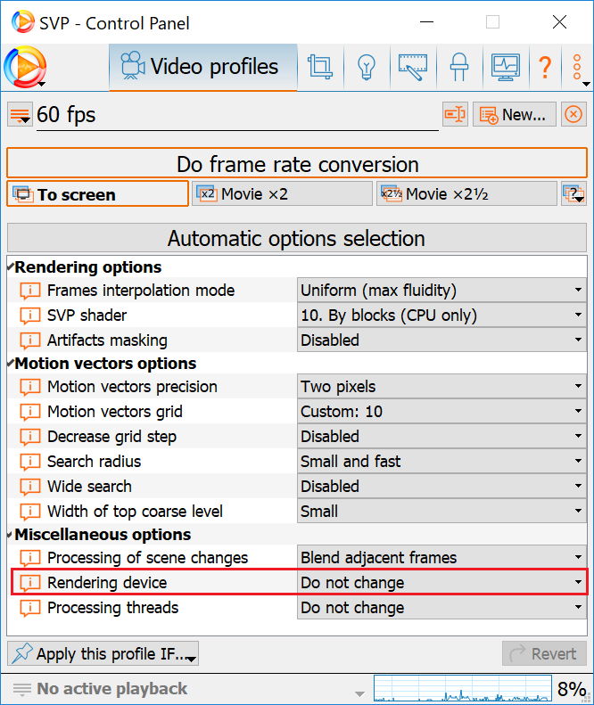

Sorry but where do I "just remove ("Do not change") / re-set "Rendering device" value"? Also the intel thing may be because I disabled my integrated GPU in bios like 6 months ago.
I have also now tried uninstalling and reinstalling SVP 4 Pro and DDU again with older Nvidia drivers that I know have worked in the past
Edit: Oh... I have now found the option and see what you mean. Thank you for your support!
Re: Error: SVSmoothFps: unable to init GPU-based renderer [code 0x10002]
Reselect GPU here (or use 'Do not change' value):
Rendering device in SVP profile.png, 56.48 kb, 666 x 791
