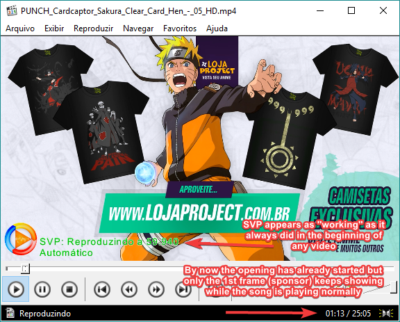

Ok so i've been using SVP for quite a while now (a year and a half) and i've never found any problems with it, but recently (since 1 week ago) i've downloaded animes from the same sub that i always did but the video doesn't start with the MPC-HC x32 in the newly downloaded ones, even if it shows that SVP is activated (the audio works fine tho). Basically: The animes i've downloaded since last week don't play the video w/ ffdshow in x32 anymore (to be more specific) even if SVP shows up as ''Activated''.

2018-02-11_05-05-53.png, 340.26 kb, 576 x 463

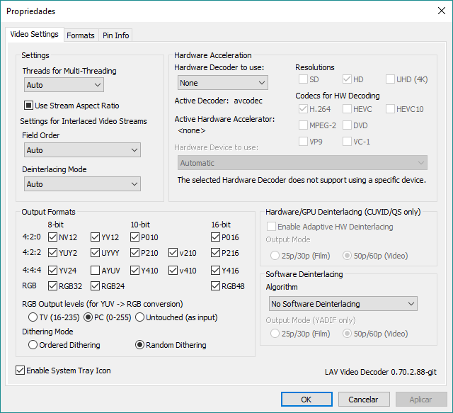

When you downloaded 32 bit LAV, could you post a screenshot of LAV decoder settings?
This? Btw i download my codecs from this site http://www.free-codecs.com/k_lite_mega_ … wnload.htm , idk if it's a codec problem but i never had any issues with that before so if i say something wrong pls correct me :X

Re: Can't use SVP on newly downloaded animes
I would use d3d11 cb decoder, dxva cb is perfectly fine too
