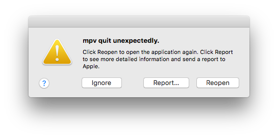

When I try to play video files via SVP, it quits as soon as I click them...
I'm currently using the new macbook pro 13inch so I don't think performance is the problem..

try to turn off OSD messages in SVP's menu
and please copy here the "Report..." text
Re: mpv keeps quitting
Thank you, after turning off OSD messages it's not crashing anymore.
