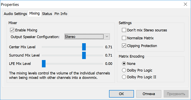

If you have stereo speakers then use LAV audio settings:
while playback open MPC-HC menu Play - Filters - LAV Audio Decoder (internal)
Then select "Stereo"
LAV_audio_decoder.png, 64.11 kb, 633 x 331
Re: Audio volume boost with MPC-HC
Thank you very much!
I had to enable the "Enable Mixing" option.
If you have stereo setup speakers you might want to enable "Don't mix Stereo sources" as well while you're at it.
