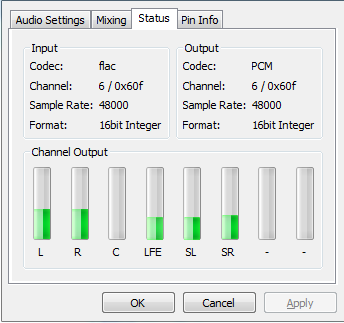

5 (edited by Porkey 18-04-2017 11:44:19)
Re: Only Left Speaker on 7.1 USB headset
Showing activity on multiple channels, still only hearing in my left ear.
Can I change the audio filter to something other than LAV?
MPFailed.PNG, 12.71 kb, 344 x 323
Should be able to add under External Filter.
Don't have a suggestion as to what filter to use/download.
