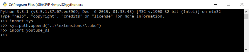

Do you have a system-wide Python installation?
Can you run SVP 4\mpv32\python.exe ?
If yes, will it execute the following commands w/o errors?
import sys
sys.path.append("..\\extensions\\tube")
import youtube_dl
python-cmd.png, 8.8 kb, 849 x 178
Re: SVP Tube 2 not detecting links
Heres what it looks like, i get No mudule named 'youtube_dl'
http://i.imgur.com/YYC8Gec.png
a typo near "extensions}}tube"
ok sorry about that didnt notice :X
looks the same as urs
http://i.imgur.com/4knt5Hx.png
well... what is your PATH value?
echo %PATH%
