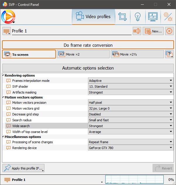

What is the considered normal CPU usage when running SVP 4 with MPC-HC?  It seems to be using 70% of my CPU at all times.  Without SVP turned on, cpu load is very light for MPC.
I am running an i7-4770k overclocked to 4.3ghz.  I am using MadVR without any "enhancement" settings but just to detect and remove black bars.  I have the paid version of SVP if that makes any difference.
I guess I am okay with the CPU usage but I'd like to lower it if possible.
Tried running at movie x2 which is ~48fps but there seems to be any audio desync.  ~60hz looks best right now.
Thanks
my_svp_settings.jpg, 109.78 kb, 602 x 633

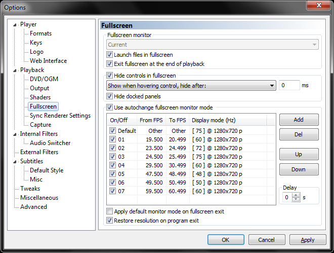

But even for 48Hz, there's still the built-in refresh rate/resolution changer in MPC-HC; I've attached the screenshot used in my "concepts" thread to this post (it is merely an example - you would obviously want to use 50Hz instead of 75Hz for 25fps videos due to your aforementioned frame-skipping).

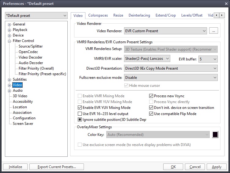

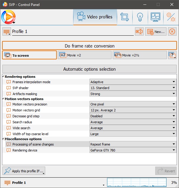

Just want to point out that I've switched over to PotPlayer x64 and the CPU usage has gone way down.
There's almost no artifacts now.  I no longer use MadVR but instead use EVR custom present as the video renderer.
edit* artifacts masking should be set to strong not strongest
