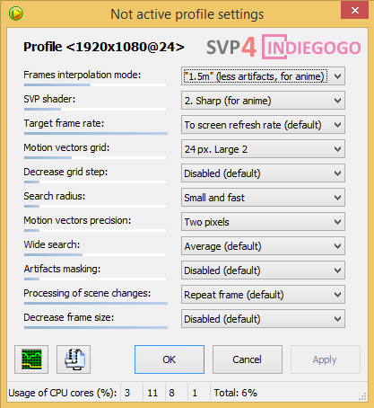

It's really weird. Whenever I try to watch any video(specifically anime), the frame is 60fps and no audio stutter but if I close MPC-HC and reopen another anime, it always audio stuter and frame dropped.
Sometimes, the frames is good but the audio still stutter. This message always appearing on screen http://prntscr.com/d8fs5u warning SVP Index. Beside, if neither of those happened the audio will off sync. I always close all background windows but still get the same result. I used kodi and stream the video on MPC-HC using some tweaking. I watched the video live from Kodi, so the video will be buffering while I'm watching the video.
PC Specs:
CPU : AMD A8-5550M APU 2.1 GHz
RAM : 4GB
Graphics: AMD A8 8550G + R5 M200 Dual Graphics
OS: Windows 8.1 Professional 64 bit
p/s: I'm using 3.1.7 version of SVP because it's better(I think)
Screenshot_1.png, 27.78 kb, 417 x 454
Screenshot_2.png, 38.47 kb, 659 x 498

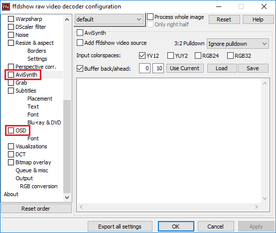

You need to disable OSD and Avisynth tab in ffdShow settings window.
Do it with SVP undloaded.
ffdShow_OSD.png, 19.31 kb, 554 x 468
