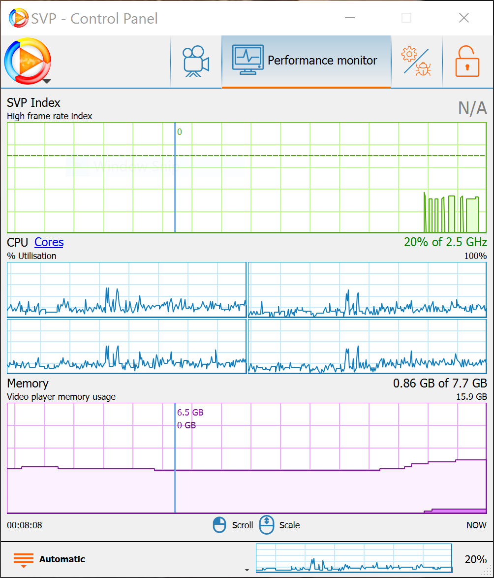

If not then show SVP Index and CPU load graphs.

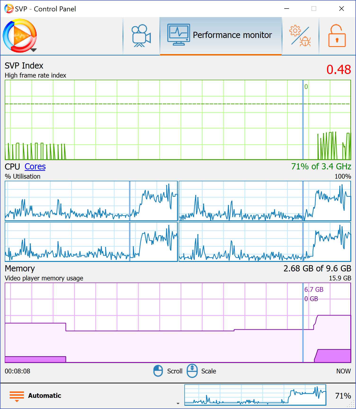

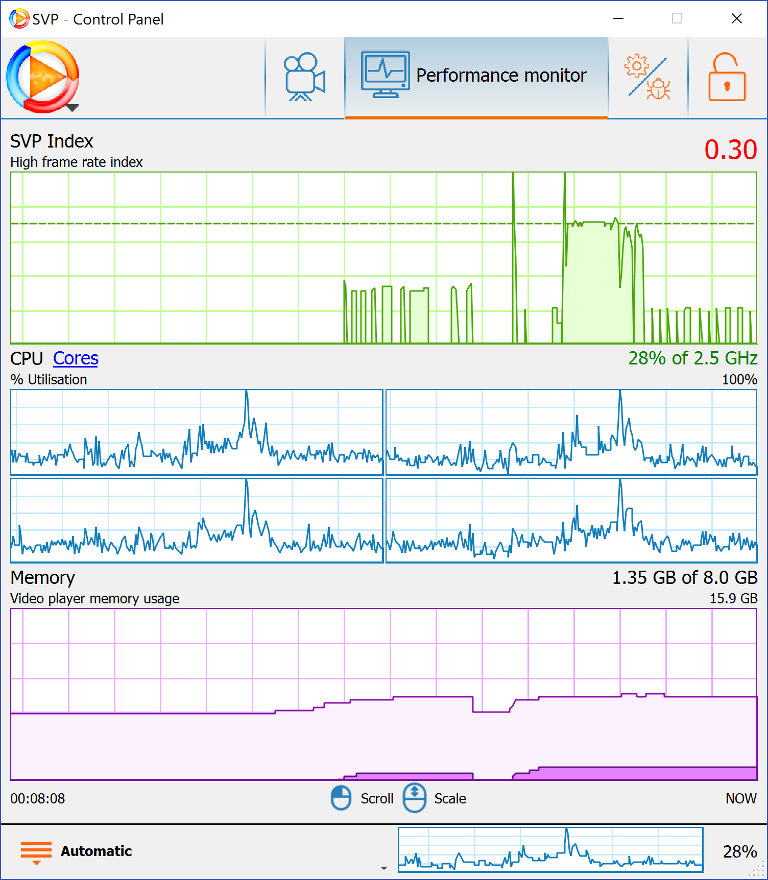

No, unfortunately dlr5668's advice didn't help me. I am therefore attaching the graphs as requested: the first screenshot is taken while playing a 480p file, the second one while playing a 1080p file and the last one while playing a 2160p file. However, the index drops to N/A everytime the audio/video lags.
I don't have pro at this point. I might consider it even if it's just to support the devs, but I'd rather make sure that it works BEFORE I pay for it wink.
On a relevant note, I just realized that the issue persists even if SVP is turned OFF, so there's definitely something funky going on with MPC or my codec/filter settings. I did several clean installs, so it seems to be something that is included in SVP's auto-setup.

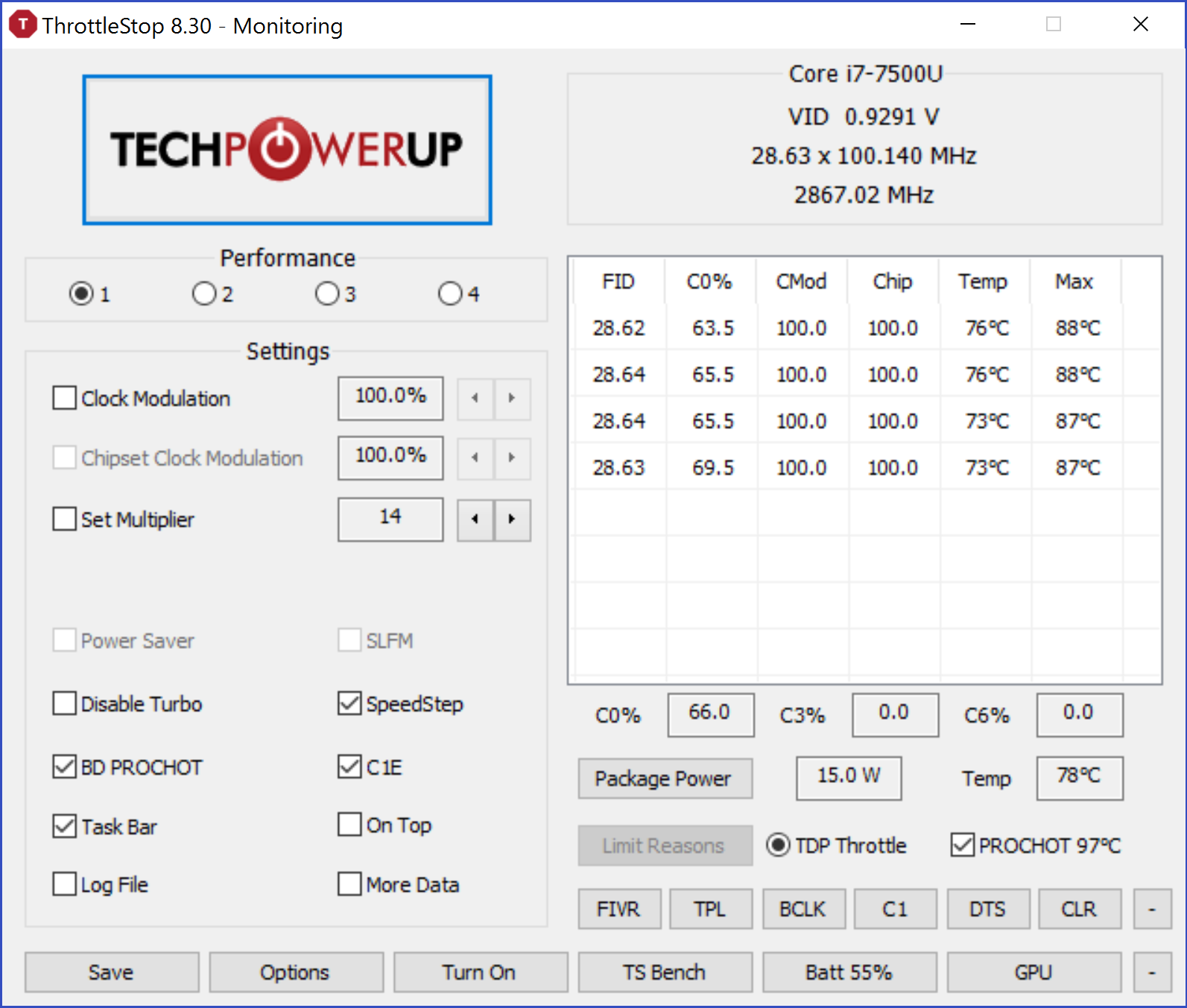

Just to add to my previous post, I ran ThrottleStop alongside SVP with 4K video playing, and it shows that no throttling is happening whereas the CPU activity is at about 60%, so it's definitely not a CPU issue (see screenshot if you're interested).
I'd really appreciate it if I didn't have to see more CPU hate posts here. I think my screenshots and test results demonstrate that the CPU is more than sufficient for basic SVP usage and the problem must lie somewhere else.
I don't really understand why you jumped to CPU power rightaway anyways, considering how old SVP is and how slow the first machines were that it was designed for. Seriously, the U series might be a little slower than other i7 CPUs, and their marketing as i7 might go against the grain of someone performance-minded, but it's still a quite decent mobile CPU and it's certainly not appropriate to call it "garbage", if you take it for what it is, even performance-wise and in respect to SVP usage. It's not like I'm trying to render the latest Pixar movie on my ultrabook.

I agree, I'm 99% sure performance isn't your issue. Even if it is throttling to, say, 2ghz, it should still be faster than my 4 ancient Stars cores at their stock 1.5ghz.
On top of that, it sounds like the issue happens immediately. If it really were throttling, it wouldn't happen until a minute or a few minutes later.

However, as someone else mentioned, that 2nd screenshot does look alot like a throttling issue... I get what you're saying, but just keep that in mind and don't rule it out just yet. SVPmark and the SVP benchmark that sets settings could be finishing before the throttling, which means the latter is setting your default SVP settings too high.

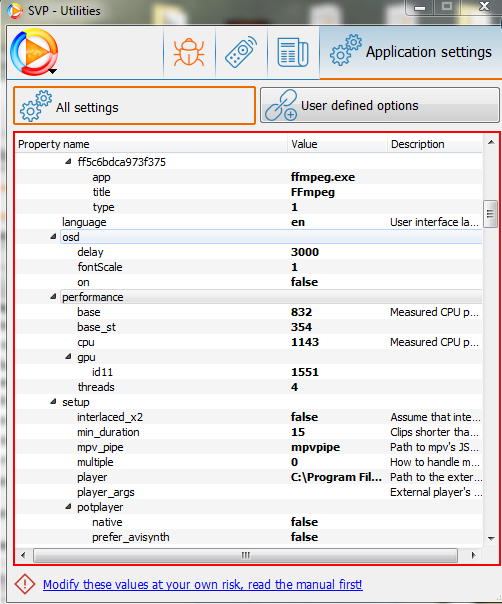

Does free version allows to use additional settings like this? If so, enter 3 values in Performance tab 2 times smaller than mine. Close and reboot and try again.
SVP performance.PNG, 72.61 kb, 502 x 604

MPV is significantly faster for me. I can decrease the motion vectors grid by 1 or 2 notches over what my CPU can normally handle.
Anyway, you should try manually decreasing settings too. Start with a large motion vector grid and 2 pixel precision, just to see if it works.

Your own screenshot clearly shows 28% CPU load at playback resulting 0.3 index score (which is literally what means throttling) while your title claims it's "high load" and you say you were not mislead by marketing? The real CPU clocks were even less than 20% because overall score is miscalculated due to Hyperthreading and you still look for a magic fix which is not related to this issue?
Did you follow my advice about ThrottleStop? Where you could see CPU behavior while playback and possibly tinker with adjusteable TDP settings? Because another real advice aside this would be... don't buy ultrabooks for SVP.
UPDATE: after brucethemoose mentioned that you wrote an update I suggest you to launch ThrottleStop again, uncheck BD Prochot box, check if you can uncheck TDP Throttle or it just show you that TDP throttle was turned on on your system, Turn ON Throttlestop itself (button) and look if you can adjust TDP to higher values (TPL if I am correct).

Did you buy pro? You have to reinstall it if you do, I believe.
The settings menu looks like this:
https://imgur.com/a/R8nld

Except throttlestop was already tried, and didn't work.
I see checked TDP Throttle on the screenshot as well as BD Prochot too and ThrottleStop wasn't even turned ON LOL. How could it work then? But yeah, after you pointed that I updated my original post with further actions to do.
P.S. And yeah, you got something right. It's possible to disable Turbo by Throttlestop and run SVP performance test... as well as to always keep CPU without turbo if temperature or TDP starts lowering clocks below default clocks.

Just for the heck of it, I used ThrottleStop to disable turbo and did another SVPmark, and while the results were worse than before, they were enough for 60fps at "good" settings.
