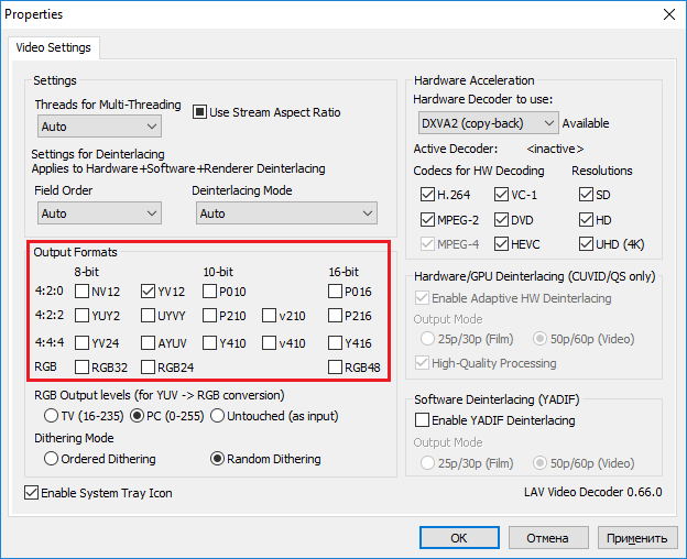

What if you select output 8bit YV12 only in LAV?
LAV_YV12_output.png, 33.88 kb, 624 x 508
Same problem still happens.
