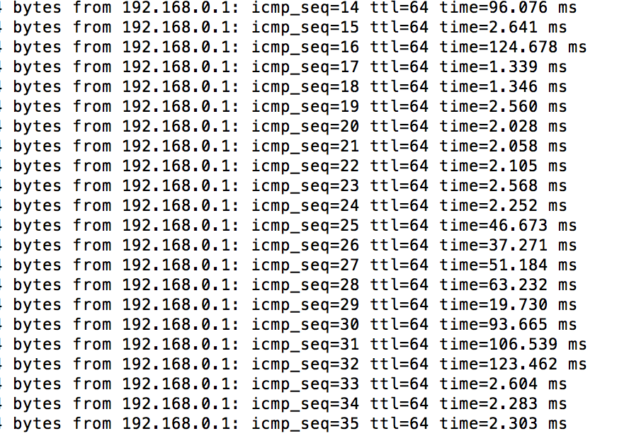

I've sent multiple bug reports on this already through SVP manager over the period of a few months. It still has not been fixed so I'm bringing it to attention here.
SVP Manager causes network card to stall periodically when open (even when not playing video), as you can see from the attached image. This problem exists on OS X 10.11 - MacOS 10.12 on ALL macs with wireless functionality.
I use SVP to filter streamed youtube videos (Using youtube-dl). This bug causes issues with streams. During the stalls, the max network bandwidth I was able to get was about 3mb/s (far too slow for 4k/8k streams or even 1080p - note: nominal speeds are about 1200mb/s on my network). Please fix.

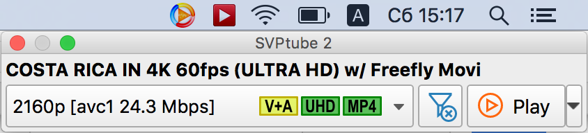

Can you be more specific?
I can view 4K youtube videos with mpv player at normal speed without stops and stuttering.
For example I took this video: https://www.youtube.com/watch?v=iNJdPyoqt8U
And selected the highest bitrate 4K variant. It plays good for me.
I use OS X 10.11.6, wi-fi connection only.
What I need to do to repeat the problem? I don't understand.
BTW. What is shown on your picture? hmm
Снимок экрана 2016-10-22 в 15.16.59.png, 61.17 kb, 844 x 192
ping 192.168.0.1
Round trip time to the gateway suddenly increased up to 120 ms for some reason
However I can't see how an user-space application like SVP could possibly do this.
Only if it consumes a lot of bandwidth, which it doesn't.

Having SVP manager running will cause ping to rise to ~100ms periodically. The image is a ping series to my router, sent once per second. Nominal operation is usually 1-4 ms. Whenever SVP manager is open, it shoots up to 20-200ms.
Yes the video streams will still load, but only after the stall is over. (Alternates between stall and normal every 5-10 seconds). Basically it makes it take longer to start the stream in the case that you try to start it during the lag spike.
