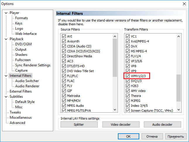

Looks like MPC-HC uses Microsoft DMO decoder to decode your WMV. It is not compatible to ffdShow and to SVP.
So, you need to switch to internal decoder LAV in MPC-HC.
MPC-HC - menu View - Options... - Internal Filters - enable WMV 1/2/3 - OK
MPC-HC_internal_WMV_decoder.png, 30.3 kb, 646 x 488

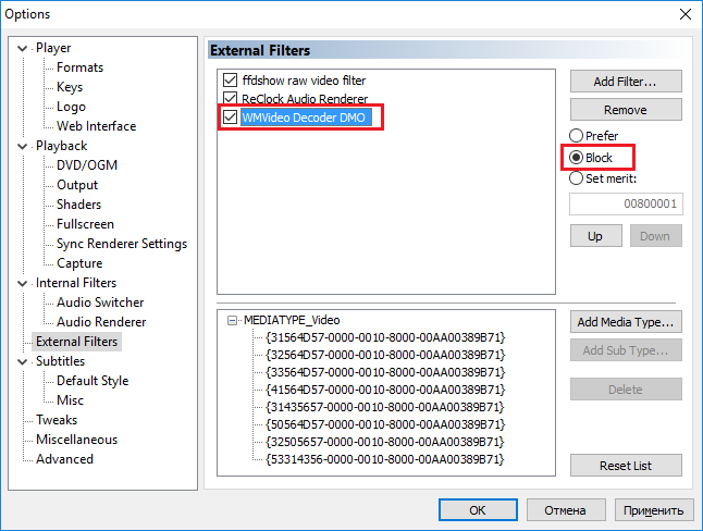

Filters currently loaded:
  - Default DirectSound Device
  - Enhanced Video Renderer (custom presenter)
  - Audio Switcher
  - WMVideo Decoder DMO
  - LAV Audio Decoder (internal)
  - AVI Splitter
  - File Source (Async.)
Re: help please i cant play this file on svp
WMVideo Decoder DMO
This is the cause. It prevents ffdShow to load in the filters chain.
Try to disable DMO decoders. Use Block option in MPC-HC External Filters tab.
Press 'Add Filter...' - select in the list 'WMVideo Decoder DMO' - check it - mark as 'Block' - OK
Block_DMO_decoders.png, 23.09 kb, 646 x 488
