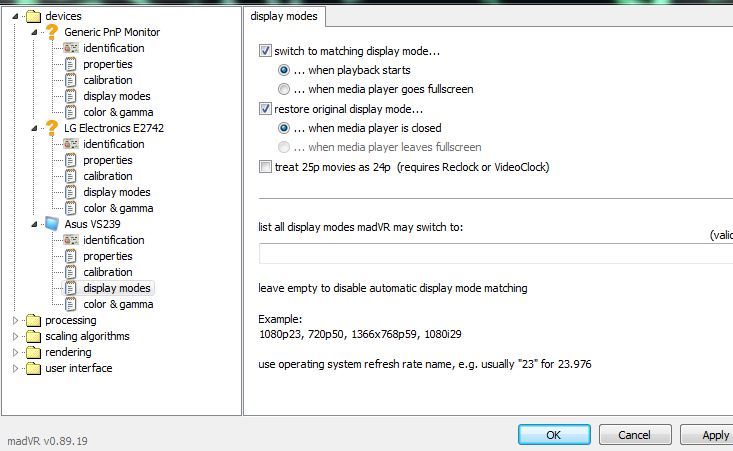

While I'm no expert in madVR upscaling, I do know how to do automatic resolution stuff.  In the madVR settings, it's under "devices" -> [your monitor] -> "display modes" and then in the text field "list all display modes madVR may switch to" type in "2560x1080p60, 2560x1080p50" (without quotes).
screenshot.jpg, 49.98 kb, 733 x 451

Yes.  Now you just have to configure madVR to use it.
ok i did it, great thanks for the help, whenever you can help me with more feel free to post http://i.imgur.com/zdMOxQP.png
