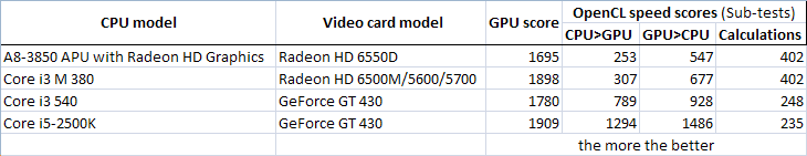

You can choose Video card by comparing SVPmark results (google spread sheet).
I get some results from there about GT430 and HD6550 (results of 6570 are absent to this moment). Here the table.
http://www.svp-team.com/forum/misc.php?item=647
Both the video card are enough to SVP, but 430 have better transfer speed, 6550 - better calculation speed. Transfer speed and GPU Score depends on CPU speed and MoBo shipset. wink
