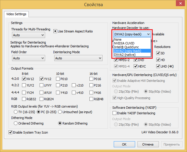

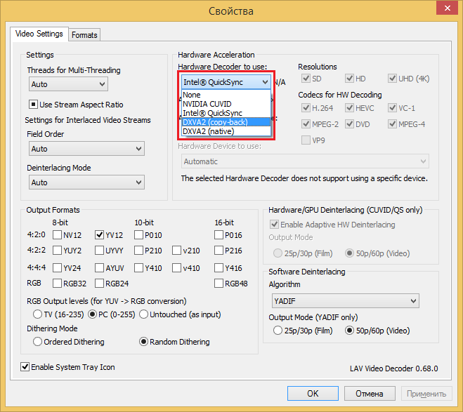

Re: How do you lower frames to 48 fps from 144 fps in SVP4?
cookieboyeli
how to switch between them
For example in LAV Vdeo Settngs: MPC-HC - menu View - Options... - Internal Filters - Video decoder
LAV68_HW_decoder.png, 31.09 kb, 659 x 587
LAV_HW_decoders.png, 29.19 kb, 638 x 520
