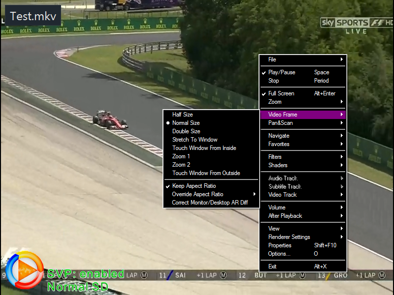

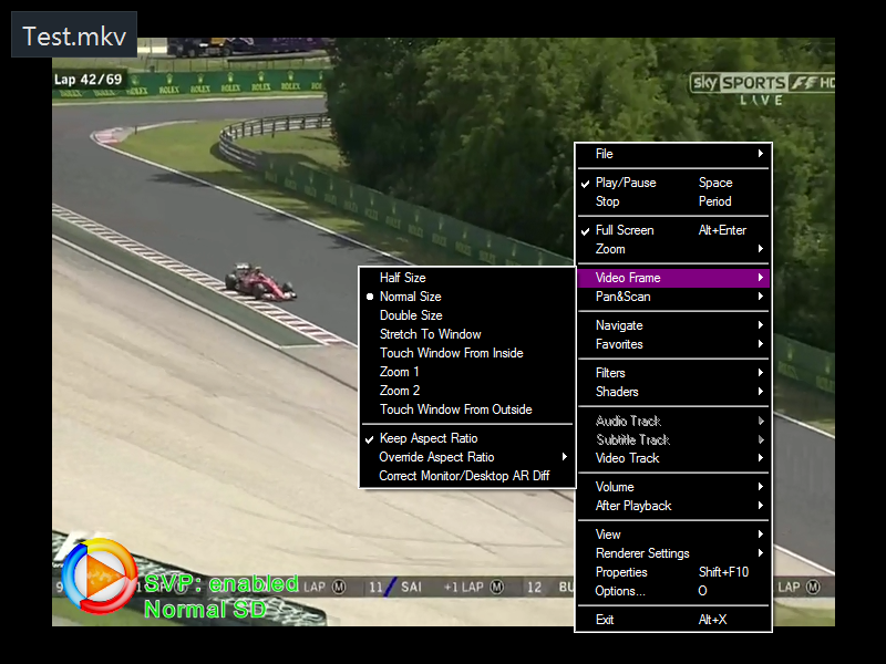

1. In SVP, enable "Decrease to screen"
2. In MPC-HC, set "Video frame" to "Normal"
3. In MPC-HC, enable "Launch files in fullscreen"
4. Set your desktop resolution to 800x600 (make sure your GPU scaling options are set to either "full screen" or "preserve aspect ratio"; also disable MPC-HC's automatic resolution changer)
5. Download the attached "Test.mkv" file and play it back in MPC-HC
6. Observe how there are black bars on ALL sides of the screen
By comparison, if you do the exact same steps but have "Decrease to screen" disabled in SVP, the video will not have black bars on all sides (refer to the screenshots).

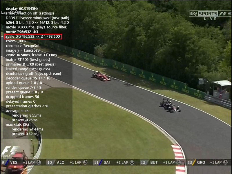

So if your screen has resolution 800x600 then one side of video must be equal, second side must be less. I think so because SD 720x576 with 16:9 flag gives at output 1024x576. (upscale 720 to 1024).
If we go with this logics then we need to get 800x5xx from 900x600 source to get stretched frame to 800x600 at the screen. And if I use madVR I see this logics working.
But with EVR I see another logics and 800x5xx shows me black bars as at your picture.
I must say it is not simple situation. Two different renderers work in different way: madVR used upscale, EVR used downscale.
