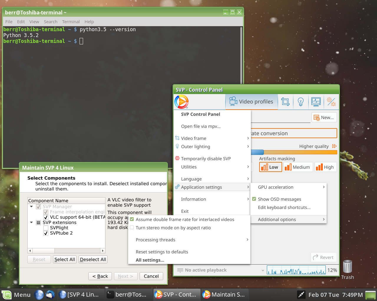

Well it didn't seem to work...SVPtube2 didn't even bring up the little window showing that it identified a Twitch.tv video from your clipboard (YouTube worked perfectly fine though).
it sounds like you just don't have vapoursynth libraries installed
I thought I did, but I'll check again.  I mean, I thought I had Qt and stuff installed as well but manually downloading and installing the newest versions and then re-installing SVP made that stuff work, so who knows?
nope

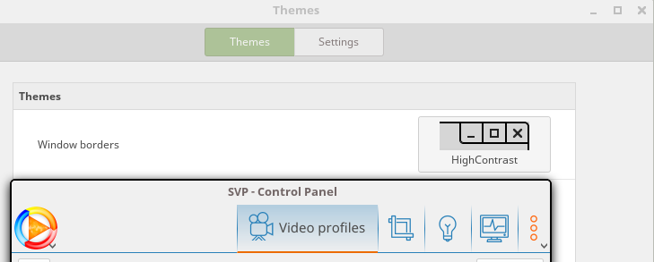

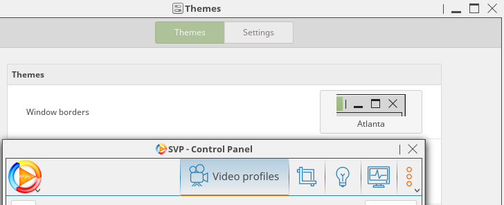

Well, as shown in my previous screenshot, there's no close button in the title bar.  I mean, I can close it via SVP Menu -> Exit and by right-clicking on the taskbar -> Close, but if there's supposed to be a close button then something clearly ain't right.
Direct link to the aforementioned screenshot for your convenience (notice how there is a close button on the terminal window):
http://www.svp-team.com/forum/misc.php? … mp;preview

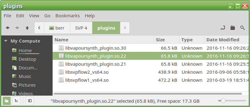

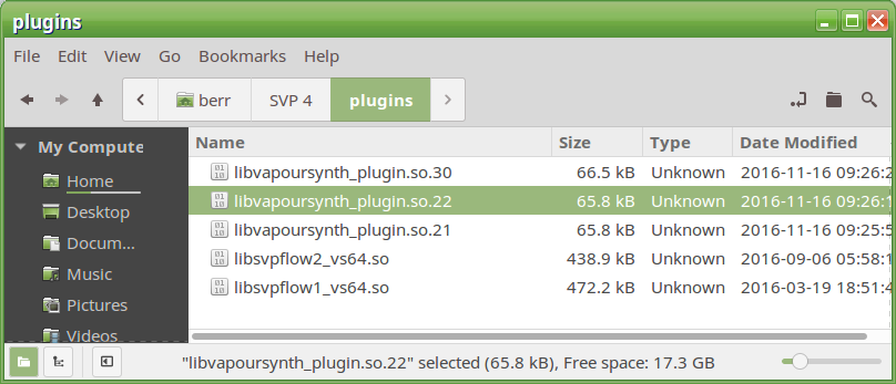

SVP 4# ldd plugins/libvapoursynth_plugin.so.22
Well, it's there.
I tried the "install newest versions and re-install SVP", but nothing changed; I even installed python 3.6 in the process.

    libsmb-transport.so.0 => /usr/lib/x86_64-linux-gnu/samba/libsmb-transport.so.0 (0x00007f463e430000)
    libsamba-credentials.so.0 => /usr/lib/x86_64-linux-gnu/libsamba-credentials.so.0 (0x00007f463e21e000)
    libCHARSET3.so.0 => /usr/lib/x86_64-linux-gnu/samba/libCHARSET3.so.0 (0x00007f463e01a000)
    libndr-samba.so.0 => /usr/lib/x86_64-linux-gnu/samba/libndr-samba.so.0 (0x00007f463dcfb000)
    libdbwrap.so.0 => /usr/lib/x86_64-linux-gnu/samba/libdbwrap.so.0 (0x00007f463daf0000)
    libdcerpc-binding.so.0 => /usr/lib/x86_64-linux-gnu/libdcerpc-binding.so.0 (0x00007f463d8d2000)
    libutil-tdb.so.0 => /usr/lib/x86_64-linux-gnu/samba/libutil-tdb.so.0 (0x00007f463d6ce000)
    libsamba-sockets.so.0 => /usr/lib/x86_64-linux-gnu/samba/libsamba-sockets.so.0 (0x00007f463d4b7000)
    libinterfaces.so.0 => /usr/lib/x86_64-linux-gnu/samba/libinterfaces.so.0 (0x00007f463d2b3000)
    libmessages-dgm.so.0 => /usr/lib/x86_64-linux-gnu/samba/libmessages-dgm.so.0 (0x00007f463d0aa000)
    libiov-buf.so.0 => /usr/lib/x86_64-linux-gnu/samba/libiov-buf.so.0 (0x00007f463cea7000)
    libserver-id-db.so.0 => /usr/lib/x86_64-linux-gnu/samba/libserver-id-db.so.0 (0x00007f463cca3000)
    libutil-reg.so.0 => /usr/lib/x86_64-linux-gnu/samba/libutil-reg.so.0 (0x00007f463caa0000)
    libmessages-util.so.0 => /usr/lib/x86_64-linux-gnu/samba/libmessages-util.so.0 (0x00007f463c89d000)
    libsmbd-shim.so.0 => /usr/lib/x86_64-linux-gnu/samba/libsmbd-shim.so.0 (0x00007f463c69a000)
    libtdb-wrap.so.0 => /usr/lib/x86_64-linux-gnu/samba/libtdb-wrap.so.0 (0x00007f463c497000)
    libserver-role.so.0 => /usr/lib/x86_64-linux-gnu/samba/libserver-role.so.0 (0x00007f463c294000)
    libnsl.so.1 => /lib/x86_64-linux-gnu/libnsl.so.1 (0x00007f463c07b000)
    libtdb.so.1 => /usr/lib/x86_64-linux-gnu/libtdb.so.1 (0x00007f463be66000)
    libcap.so.2 => /lib/x86_64-linux-gnu/libcap.so.2 (0x00007f463bc5f000)
    libutil-setid.so.0 => /usr/lib/x86_64-linux-gnu/samba/libutil-setid.so.0 (0x00007f463ba5d000)
    libkrb5-samba4.so.26 => /usr/lib/x86_64-linux-gnu/samba/libkrb5-samba4.so.26 (0x00007f463b7f0000)
    libaddns.so.0 => /usr/lib/x86_64-linux-gnu/samba/libaddns.so.0 (0x00007f463b5e5000)
    libgssapi-samba4.so.2 => /usr/lib/x86_64-linux-gnu/samba/libgssapi-samba4.so.2 (0x00007f463b3b3000)
    libauthkrb5.so.0 => /usr/lib/x86_64-linux-gnu/samba/libauthkrb5.so.0 (0x00007f463b198000)
    libcli-nbt.so.0 => /usr/lib/x86_64-linux-gnu/samba/libcli-nbt.so.0 (0x00007f463af8e000)
    libmsghdr.so.0 => /usr/lib/x86_64-linux-gnu/samba/libmsghdr.so.0 (0x00007f463ad8a000)
    libselinux.so.1 => /lib/x86_64-linux-gnu/libselinux.so.1 (0x00007f463ab67000)
    libgcrypt.so.20 => /lib/x86_64-linux-gnu/libgcrypt.so.20 (0x00007f463a886000)
    libFLAC.so.8 => /usr/lib/x86_64-linux-gnu/libFLAC.so.8 (0x00007f463a611000)
    libresolv.so.2 => /lib/x86_64-linux-gnu/libresolv.so.2 (0x00007f463a3f5000)
    libpcre.so.3 => /lib/x86_64-linux-gnu/libpcre.so.3 (0x00007f463a185000)
    libicudata.so.55 => /usr/lib/x86_64-linux-gnu/libicudata.so.55 (0x00007f46386ce000)
    libaec.so.0 => /usr/lib/x86_64-linux-gnu/libaec.so.0 (0x00007f46384c5000)
    libkrb5.so.3 => /usr/lib/x86_64-linux-gnu/libkrb5.so.3 (0x00007f46381f3000)
    libk5crypto.so.3 => /usr/lib/x86_64-linux-gnu/libk5crypto.so.3 (0x00007f4637fc4000)
    libcom_err.so.2 => /lib/x86_64-linux-gnu/libcom_err.so.2 (0x00007f4637dbf000)
    libkrb5support.so.0 => /usr/lib/x86_64-linux-gnu/libkrb5support.so.0 (0x00007f4637bb4000)
    libsasl2.so.2 => /usr/lib/x86_64-linux-gnu/libsasl2.so.2 (0x00007f4637999000)
    libgssapi.so.3 => /usr/lib/x86_64-linux-gnu/libgssapi.so.3 (0x00007f4637757000)
    libasn1-samba4.so.8 => /usr/lib/x86_64-linux-gnu/samba/libasn1-samba4.so.8 (0x00007f46374dd000)
    libcli-ldap-common.so.0 => /usr/lib/x86_64-linux-gnu/samba/libcli-ldap-common.so.0 (0x00007f46372d4000)
    libwinbind-client.so.0 => /usr/lib/x86_64-linux-gnu/samba/libwinbind-client.so.0 (0x00007f46370d0000)
    libldb.so.1 => /usr/lib/x86_64-linux-gnu/libldb.so.1 (0x00007f4636ea3000)
    libwbclient.so.0 => /usr/lib/x86_64-linux-gnu/libwbclient.so.0 (0x00007f4636c94000)
    libsamba-modules.so.0 => /usr/lib/x86_64-linux-gnu/samba/libsamba-modules.so.0 (0x00007f4636a91000)
    libsamdb.so.0 => /usr/lib/x86_64-linux-gnu/libsamdb.so.0 (0x00007f463687a000)
    libsamdb-common.so.0 => /usr/lib/x86_64-linux-gnu/samba/libsamdb-common.so.0 (0x00007f4636652000)
    libldbsamba.so.0 => /usr/lib/x86_64-linux-gnu/samba/libldbsamba.so.0 (0x00007f4636427000)
    libheimbase-samba4.so.1 => /usr/lib/x86_64-linux-gnu/samba/libheimbase-samba4.so.1 (0x00007f4636222000)
    libhx509-samba4.so.5 => /usr/lib/x86_64-linux-gnu/samba/libhx509-samba4.so.5 (0x00007f4635fdc000)
    libhcrypto-samba4.so.5 => /usr/lib/x86_64-linux-gnu/samba/libhcrypto-samba4.so.5 (0x00007f4635da9000)
    libroken-samba4.so.19 => /usr/lib/x86_64-linux-gnu/samba/libroken-samba4.so.19 (0x00007f4635b9b000)
    libwind-samba4.so.0 => /usr/lib/x86_64-linux-gnu/samba/libwind-samba4.so.0 (0x00007f4635973000)
    libndr-krb5pac.so.0 => /usr/lib/x86_64-linux-gnu/libndr-krb5pac.so.0 (0x00007f4635768000)
    libauth-sam-reply.so.0 => /usr/lib/x86_64-linux-gnu/samba/libauth-sam-reply.so.0 (0x00007f4635564000)
    libgpg-error.so.0 => /lib/x86_64-linux-gnu/libgpg-error.so.0 (0x00007f463534f000)
    libkeyutils.so.1 => /lib/x86_64-linux-gnu/libkeyutils.so.1 (0x00007f463514b000)
    libheimntlm.so.0 => /usr/lib/x86_64-linux-gnu/libheimntlm.so.0 (0x00007f4634f41000)
    libkrb5.so.26 => /usr/lib/x86_64-linux-gnu/libkrb5.so.26 (0x00007f4634cb7000)
    libasn1.so.8 => /usr/lib/x86_64-linux-gnu/libasn1.so.8 (0x00007f4634a15000)
    libhcrypto.so.4 => /usr/lib/x86_64-linux-gnu/libhcrypto.so.4 (0x00007f46347e1000)
    libroken.so.18 => /usr/lib/x86_64-linux-gnu/libroken.so.18 (0x00007f46345cb000)
    libflag-mapping.so.0 => /usr/lib/x86_64-linux-gnu/samba/libflag-mapping.so.0 (0x00007f46343c8000)
    libwind.so.0 => /usr/lib/x86_64-linux-gnu/libwind.so.0 (0x00007f463419f000)
    libheimbase.so.1 => /usr/lib/x86_64-linux-gnu/libheimbase.so.1 (0x00007f4633f8f000)
    libhx509.so.5 => /usr/lib/x86_64-linux-gnu/libhx509.so.5 (0x00007f4633d44000)
    libsqlite3.so.0 => /usr/lib/x86_64-linux-gnu/libsqlite3.so.0 (0x00007f4633a6f000)
    libcrypt.so.1 => /lib/x86_64-linux-gnu/libcrypt.so.1 (0x00007f4633836000)
berr@Toshiba-terminal ~ $

However, there's still no VLC option in SVP's menu.
Also if I open a video that is associated with SVP itself, it opens the SVP control panel in addition to mpv - having a control panel window pop up in the middle of your video isn't exactly conductive to watching said video.
I will note however that SVP's performance seems a lot worse than I had in Windows, but that could just be due to mpv requiring more CPU headroom than MPC-HC + bilinear (non-P.S. 2.0) + D3D fullscreen (which is very noticeable on a 2GHz Core 2 Duo with Intel 945GMA graphics where every bit of CPU headroom counts).

I did at least figure out why I didn't have a close button on the SVP Control Panel - for some reason, some of the themes results in there being no close button even though other non-default themes do have a close button:
has X.png, 27.02 kb, 728 x 296
no X.png, 26.16 kb, 729 x 293
