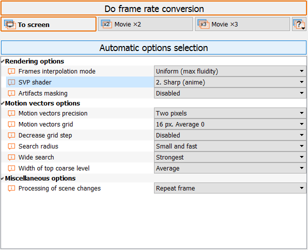

Topic: SVP works well windowed but not fullscreen
This is especially in MP4 files as the frame rate drops to 24-15 fps. In MKV files its fine but panning is kind of choppy.
PC Specs (Bought it this month)
Intel i7-6500 Core
NVIDA GeForce 940M
8.00 GB RAM
I also want to note I had a I5 processor in the past and had that computer for nearly 3 years and has no problems at all with SVP.
Auto Op Sel.PNG, 23.22 kb, 616 x 500

Let me guess - Nvidia on Window 10?  In MPC-HC, set your LAVfilters decoder to "DXVA2 (copy-back)" if you haven't already.
Some other things typically mentioned that might solve your issue:
- Enable Direct3D Fullscreen in MPC-HC if you don't use MadVR; if you do use MadVR then enable "use direct3d 11 for presentation"
- Manually set the amount of threads in SVP to a larger value (you want the smallest amount possible that gives a perfectly smooth result)
- *gasp* disable GPU acceleration in SVP; a last resort, but it's worth a shot.
