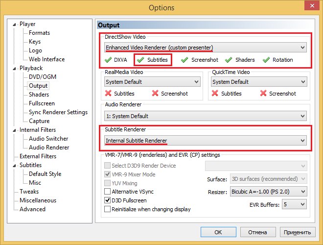

I recomend to use subtitle engine in renderer.
- disable xysubfilter;
- disable subtitle option in ffdShow;
- enable Internal Subtitle Renderer: MPC-HC - menu View - Options - Output. See picture below. Check if Subtitle makred by green sign. If no then choose another renderer. Good renderers are: EVR custom and madVR;
- enable subtitles in MPC-HC: MPC-HC - menu Play - Subtile Track - Enable;
- select subtitles in MPC-HC: MPC-HC - menu Play - Subtile Track - Select from the list above Option 'S: No subtitles'.
Subtitles_in_MPC-HC.png, 25.72 kb, 660 x 500
