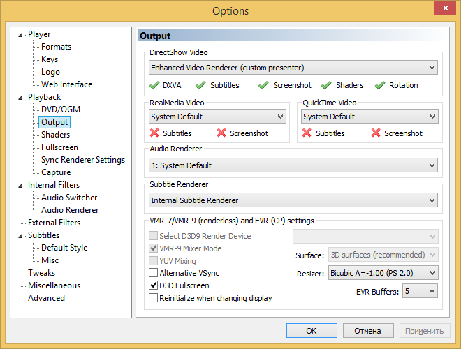

Use EVR Custom with D3D Fullscreen.
MPC-HC - menu View - Options - Output tab - select Enchanced Video Renderer (custom presenter) - enable D3D Fullscreen - select Resizer (Bilinear for weak GPU, Bicubic A=-1.0 for more sharpness for strong GPU) - OK
His GPU should be able to do bicubic easily.
However, make sure you compare the performance to bilinear (NOT the bilinear that's PS 2.0) and see if it is any slower.
