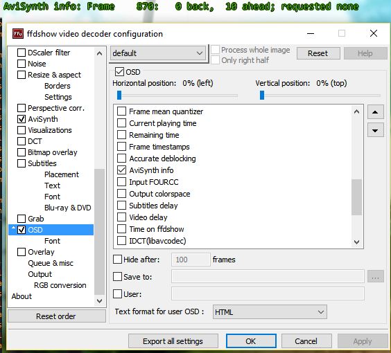

Actually you can check using ffdshow OSD->Avisynth Info on how many the actual buffer back/ahead is used. (Look picture in attachment)
But just to be save I used 20/20.
avisynth_info.JPG, 66.24 kb, 564 x 510
