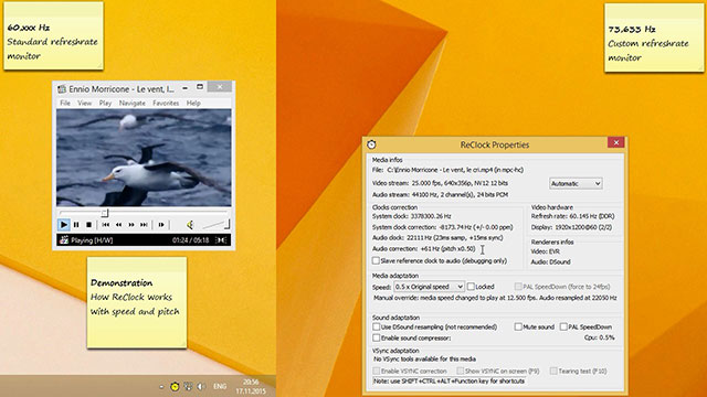

I made demonstration how you can use ReClock to get 432 Hz audio from 440 Hz in realtime.
https://youtu.be/zD2gwTC__jE
Several rules.
1. You need to add custom resolution to your display. Different for each source framerate. In video shown example with 25 fps source.
2. You need to check if your audio really 440 Hz base frequiency. It is needed to use some frequency analyzer.
3. Slowdown can be applicable mainly for instrumental music but not for voice or sounds of nature. It this case sounds are real when pitch is 1.00x at source speed.
Calculations and explanations.
25 fps soucre. Integer mutipliers 2 and 3 gives numbers 50 and 75.
I take 75 Hz and slow down it with 432/440 ratio. I got 75*432/440 = 73,636 Hz.
I used NVIDIA control panel to add this custom resolution (and frequency) to one of my monitors.
I allow ReClock to use 3% slowdown. So I got new sample rate in ReClock for 44100 Hz audio: 43296 Hz.
Make some test with calculation real ratio: 43296 / 44100 = 0,981769 It is very close to yours 0,981818.

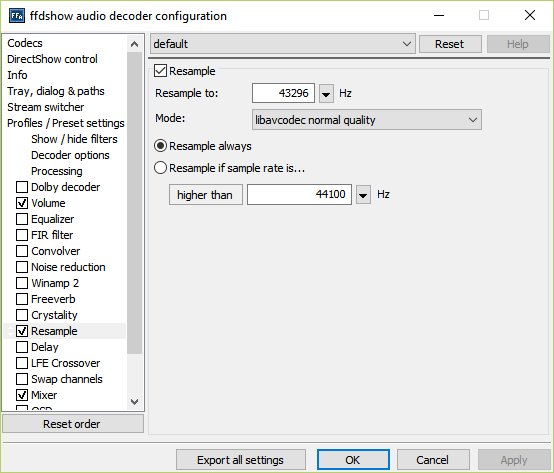

The resample in ffdshow is different?

Re: Real-time 432hz Audio Auto-Pitching
mashingan
Thank you. I will check it.

mashingan, I tried it. That didn't make any difference for me. Perhaps the audio isn't being processed by ffdshow? Adding "ffdshow Audio Decoder" in MPC-HC's external filters doesn't help.
And if it did, what about 48000hz sources?

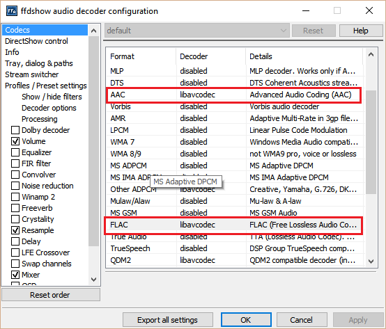

12 (edited by mashingan 18-11-2015 14:41:00)
Mystery
Don't forget to enable the codecs in Codecs tabs
CMIIW, I think it actually matches to the input source and resample it to our target Hz.

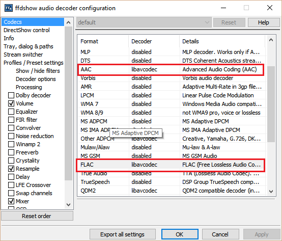

mashingan
I checked Resample option in ffdShow Audio. Pitch is not corrected for me. I see only speed changes. Very little when change and back after some seconds after.
So. The pitch not changed form 440 Hz to 432 Hz. sad

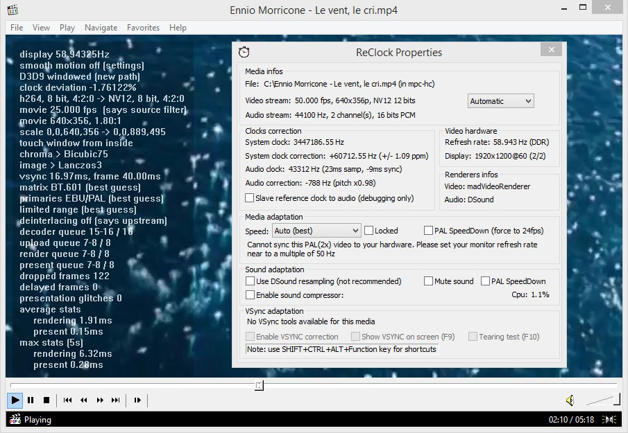

I just try Intel Custom Resolutions and Modes
So, I just now added 50 Hz mode at my monitor connected to Intel HD Graphics 4000.
I need some more time to google and to add fraction modes such as 23.976x2 * 0.981818 = 47,080 Hz.
It will be 440 to 432 Hz mode for 23,976 fps videos. wink
Somehow I got 58.943 Hz at my monitor and 43312 / 44100 = 0.982131 pitch ratio.
It gives me 440 Hz * 0.982131 = 432,13 Hz wink
50 fps at the picture it is 2x smoothing after SVP.
ReClock&Intel.jpg, 163.03 kb, 905 x 625
