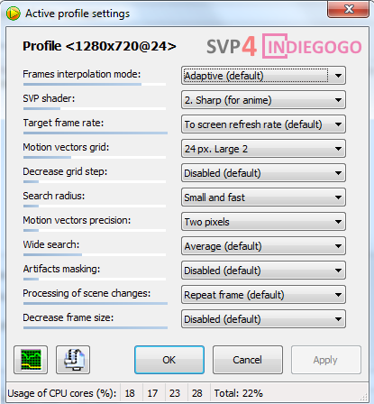

Just started using SVP to watch anime, and it's been beautiful; however, during the majority of the episode, there's a small distortion at the bottom of the screen. While I can deal with it, I would still like for it to be fixed. Here is my video settings for SVP.

Can you show distrotion with screenshot?
Is this distortion showing up in the subtitles when there's stuff moving behind them?

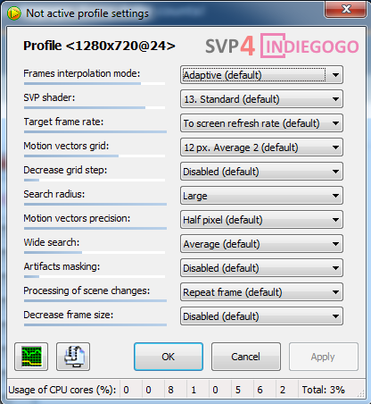

BTW, it looks as though you've set up your SVP profile (video settings) according to the old guide on the main SVP site for how to configure it for anime.  I tried that but I've found that using enhanced default settings is smoother and less distorted.  YMMV but I figure I should mention it.

Hmmm, it seems changing it to your settings has fixed the distortion. Thanks for the help.
