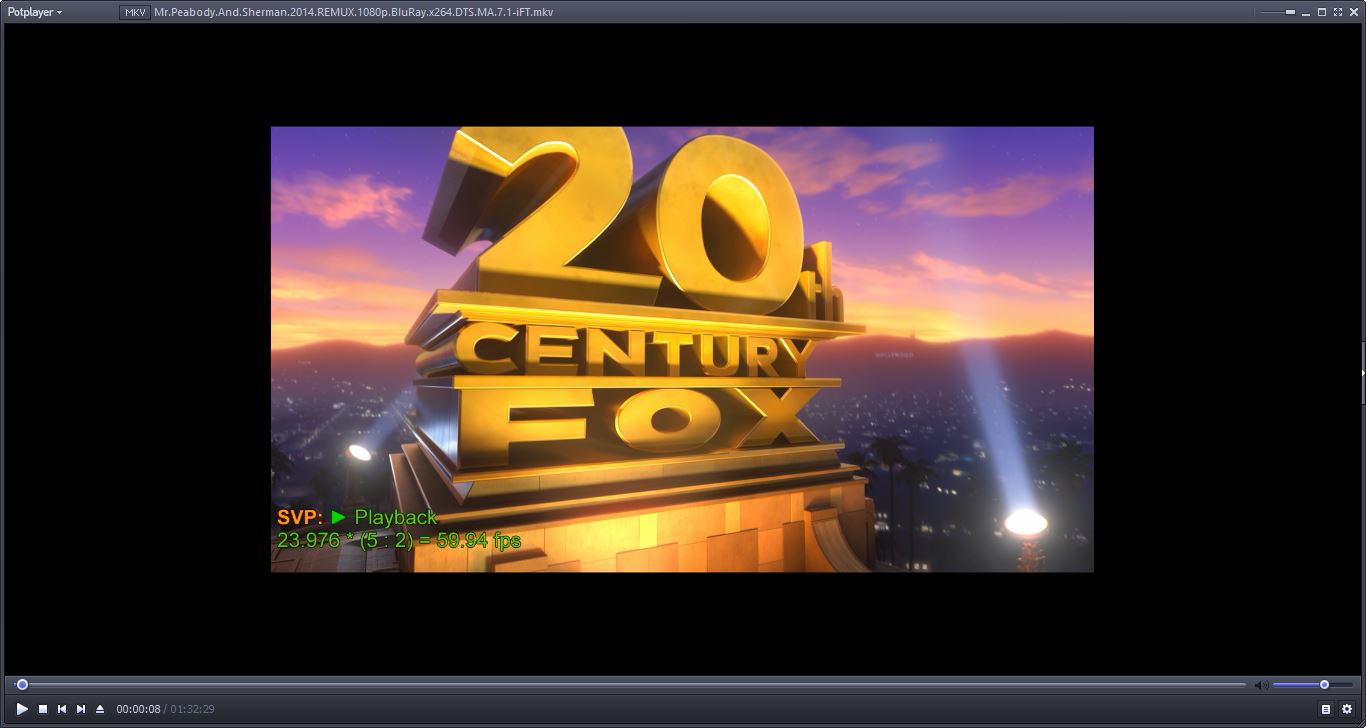

When I open a file from PotPlayer, the video is automatically resized like this (Resized.JPG)

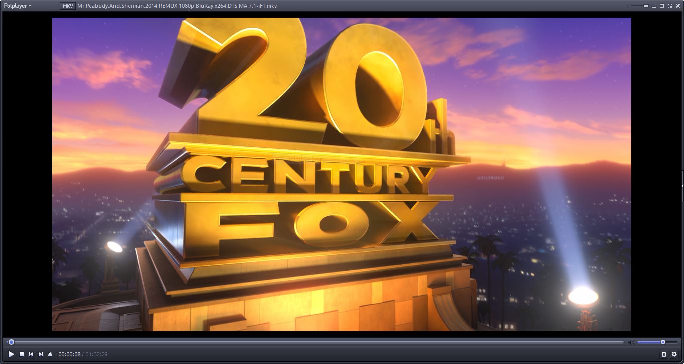

But the original one is like this (Original.JPG)
Is there any configuration problem?

Re: Video resized when using SVP on potplayer
This's because your PotPlayer setup for some reason doesn't process video frame size change correctly.
Try pressing Ctrl+Enter / Alt+Enter.
Also disabling "Built-In video processing filter" may help.
Agi_MPAS
Also you can turn of downsize picture if you have quite fast CPU to process FullHD in realtime.
SVP manager - Video profiles - Select bolded one - Decrease frame size - select Disabled - OK.
But as I can see you are watching FullHD video at non FullHD display. So you don't need to process extra pixels. wink
