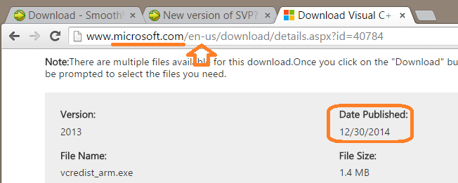

Nintendo Maniac 64
And you're not allowed to pull the American card because both of my parents and myself have lived in northeast Ohio our entire lives.
http://www.svp-team.com/forum/misc.php?item=3446&download=1
big_smile
us-date.png, 28.24 kb, 652 x 261

And Chainlink, Microsoft is a corperation, not a software developer.  You really think they don't use yyyy-mm-dd in-house?
