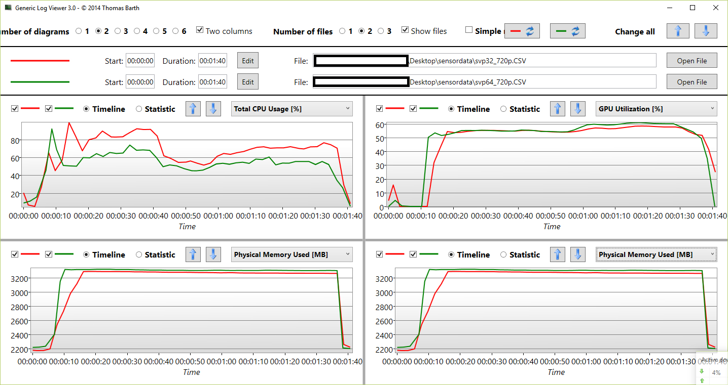

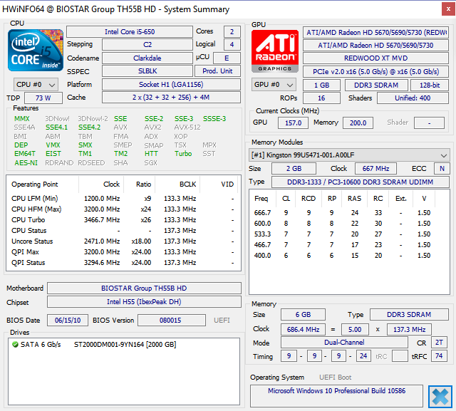

82 (edited by mashingan 03-01-2016 06:46:45)
Re: SVP with AviSynth 2.6 or AviSynth+ ?
MistahBonzai
I've shared my configuration script in this post, http://www.svp-team.com/forum/viewtopic … 563#p55563
My system is far inferior compared to yours, see the pict
Attached too the performance comparison between 32bit vs 64bit, the tested video duration only 01:40 though.
PS: I am using ffdshow from K-Lite codecs.
sys_summary.png, 53.06 kb, 640 x 577

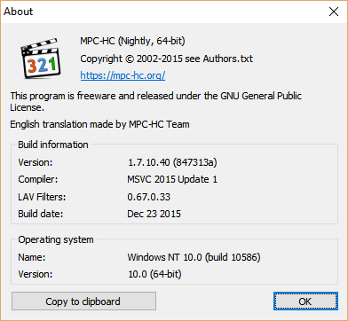

84 (edited by mashingan 04-01-2016 08:21:14)
MistahBonzai
Since you have an i7, the optimum threads is 19.
Have you ever tried to move the plugins64 to folder which not in MPC-BE folder?
In my case, I put the SVP1.dll and SVP2.dll x64 in "C:\Program Files (x86)\SVP\plugins\x64".
What version of MPC-HC do you have? Mine is 1.7.10.40, see the pic.

4. What version of MPC-HC do you have? Mine is 1.7.10.40, see the pic.
Same here.

100 (edited by MistahBonzai 16-01-2016 04:33:27)
Once again I upgraded AMD HD 7850 drivers from Catalyst 15.7.1 to Crimson 16.1 (latest hotfix) and once again the GPU Renderer (GPU:1) can't be initialized via AviSynth script within ffdshow raw video. This applies to my MPC-HC x64/madVR/LAV configuration.
MPC-BE x64 and x86 work just fine along with MPC-HC x86. When using the AMD HD 7850 15.7.1 drivers all work fine. I've played with different 64-bit AviSynth.dll files in C:\Windows\System32 but makes no difference.
I hate to stay stuck at Catalyst 15.7.1 but I'll revert until a solution is found. So, if you have successfully utilized the AMD Crimson drivers (now 16.1) with an SVP x64 configuration via AviSynth script (super_params = "{scale:{up:0},gpu:1,rc:true}") please let me in on it smile
Note: Keep in mind that the problem configuration is strictly MPC-HC x64. MPC-BE x64 is fine. Backing madVR out by switching to EVR-CP makes no difference. Error msg is [code 0x10000)  See Attached screen clip:
Capture.JPG, 20.92 kb, 683 x 51
