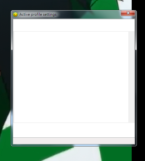

Here is the case:
A. SVP first opened, waiting for playback > playback started, working.
B. playback stopped at the middle, and resume to play. SVP will not turn to pause and keep working until it goes to C
C. previous playback closed, SVP freezed, icon stays green, does not response until
- right click (left clicks wont work)
- double click which unfreeze 5s after(see attachment #1)
Anyone have the same bug with me?
Using MPC and Madvr, standard LAV and ffshow raw filters.
This issue happening since 1 month ago.
Edit log is under 2 playback, closed the first one and opening the second one after, tried to re-install everything, couldn't work, suspected a settings problem.
擷取.PNG, 109.77 kb, 479 x 534
Re: SVP partly freezing after playback started
Can you put here your last launch log (SVP tray menu - Information) just after freezing and unfreezing SVP?

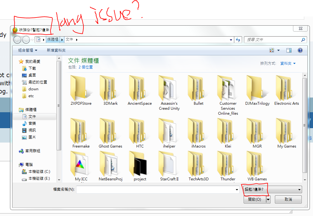

I guess avisynth.dll is indeed the (one of the)criminal, I replaced it with the one included in the SVP pack. And (part of the)bug is gone  tongue
After smooth payback starts, SVP program GUI will freeze but the video is still in smooth payback, which SVP at that moment will not able to detect any changes, including pausing stopping the video.
Here I found out that the language is not shown properly as well.
My windows7 language settings are traditional chinese(hong kong) which includes english.
Edit: reinstalled avisynth.dll now pause icon is properly displayed but closing playpack still causes the freeze
