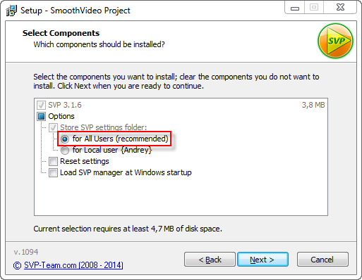

You have long User name with space letter. Try to use "for All Users" option while install SVP again.

This is the option I set when installing SVP. And SVP manager starts without problems on my administrator account (the one I install all programs and games) but it won't start on my normal account (the one I work and play on). BTW, my account name isn't long (it's three letters only and no spaces there). But I guess you are reffering to 'Dane aplikacji' - it's 'Aplications data' in English and it's standard folder name in Windows XP.

You can try to change SVP settings folder type manually with regedit: HKEY_CURRENT_USER\Software\SVP-Team\SVP\
SettingsFolderType = 2 - for Aff Users
SettingsFolderType = 1 - for Local user
After changing exit and run SVP-Manager again.

Did you try both variants of setting (All Users/Local users)?
