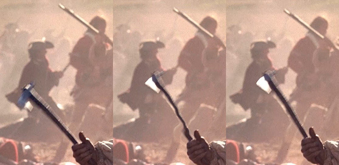

Topic: Predicted motion using algo 1 or 2 is not linear
I'm experimenting with the algorithms and there's an issue with the interpolated frames. In the picture you can see three frames, whereby the first and the third frames are original and the second is interpolated with algorithm 1. The axe is moving up with a constant speed which means that the position of the axe in the second frame should be between those of frame one and three. But, the predicted position of the axe is much closer to the third frame (almost indentical) than it is to the first. This is more like frame doubling instead of interpolation.
Also, algorithm 2 renders exactly the same frame as algorithm 1. Though, if I increase threefold the frame number (num:3 instead of num:2), there is a difference between algorightms 1 and 2. But even then I can see that the axe in the interpolated frames is too close to the original frames 1 and 4 and there is a huge jump of the axe between the two interpolated frames 2 and 3.
Is there a way to fix it?
Re: Predicted motion using algo 1 or 2 is not linear
max_pla3
Yes. You need to use scene.mode=0 (see details here). In you case The scene with axe is hard to interpolation algorithms. Scene.mode=3 is used by default to get artifact-safe position of objects instead of true position.
Change line in your script:
SVSmoothFps(super, vectors, "{rate:{num:2, den:1, abs:false}, algo: 2, scene:{mode:0}}", url="www.svp-team.com", mt=threads)
