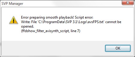

I'm getting the following error while starting to play a video with SVP active:
http://i62.tinypic.com/24y8psp.jpg
and svp log is then updated with the following entry:

22:36:24.129; Error: Error preparing smooth playback! Script error:
Write: File 'C:\ProgramData\SVP 3.1\Logs\avsFPS.txt' cannot be opened.
(ffdshow_filter_avisynth_script, line 7)
This error shows sometimes, every maybe 15-20 file opening actions.
It is source independent, the same file opened next time will not produce this error.
Error causing svp to not trigger itself but video plays ok (in its native fps)
All of this on ver 3.1.6.
I have never experienced this error on any earlier ver of SVP.
