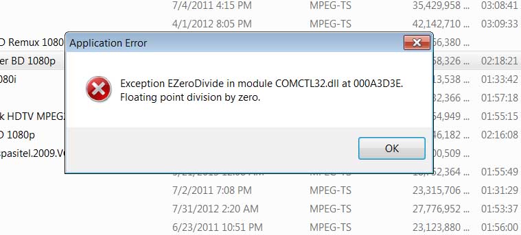

This problem started yesterday,
When i try to playback any video file it says in MCP-BE "preparing smooth playback" and then SVP shows error on the attached picture.
I start SVP Manager and the same thing happens again.
And Reclock doesn't start at all, i navigate to installation folder in order to start it, but no .exe file in there.
But I can start Configure Reclock and change setings though.
Could you help me to solve this problem?
Thanks

I don't see that It is SVPMgr's error. Error dialog title is "Application error". What application? hmm
This error in COMCTRL is not good sign. It can be virus, overheating, memory error. You need to make some stress tests of your system.

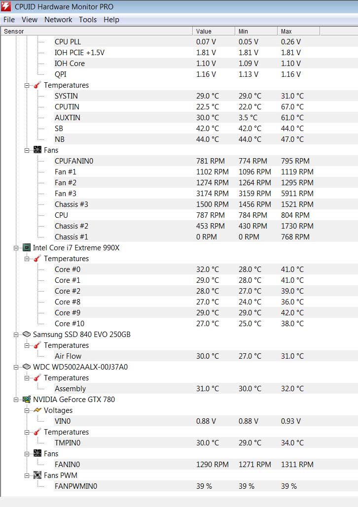

Hello Mag79!
Both cpu and gpu run on their base-clocks, no overclocking.
my specs:
CM HAF-X
CM silent pro - 1200w
mobo-AR3Formulla
corsair-12gb (6x2)
i7-990x
evga gtx-780 sc
250gb ssd
Asus pa246q
Benq w1070
Overheating is out of the question, never had any.  I have 11 fans, 3 intake, 2 outtake and 6 inside the case.
