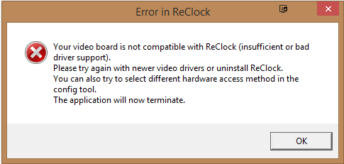

I have been having trouble getting Reclock to run successfully with MPC-HC, the reclock error.png picture shows the error I get sometimes when trying to open MPC with Reclock.
Reclock does not seem to be able to ever get a video stream found, it has found an audio stream before (yellow icon instead of red), but that is only the tip of the iceberg.

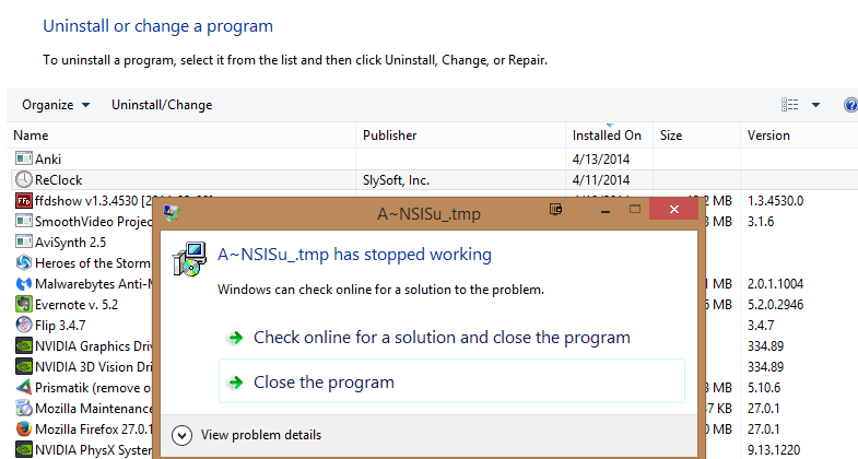

I've done a full reinstall of SVP after SVPLight was fixed in the registry per the other thread. The Reclock Uninstall.png will show the error I get sometimes when trying to uninstall Reclock, to which I was able to somehow get to uninstall after trying to install it over and over (3 or 4 times).

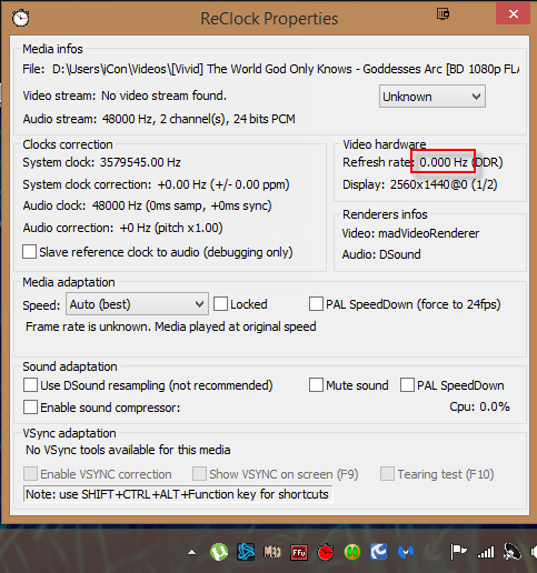

Finally the reclock running red.png shows the properties file along with the icon showing up as red, meaning that reclock wasn't able to find a stable clock etc. from what I read in the readme file.

http://www.svp-team.com/forum/misc.php?item=3144
I always use ReClock. Never seen this error.

ReClock can not determine you screen refresh rate. It can be hardware, software or driver issue. You need to solve that problem first.
As I can see you use Windows 8?

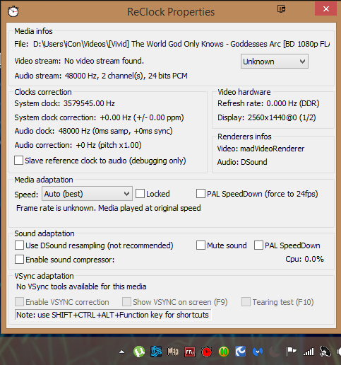

Refresh_rate_not_detected.png, 24.31 kb, 483 x 516
