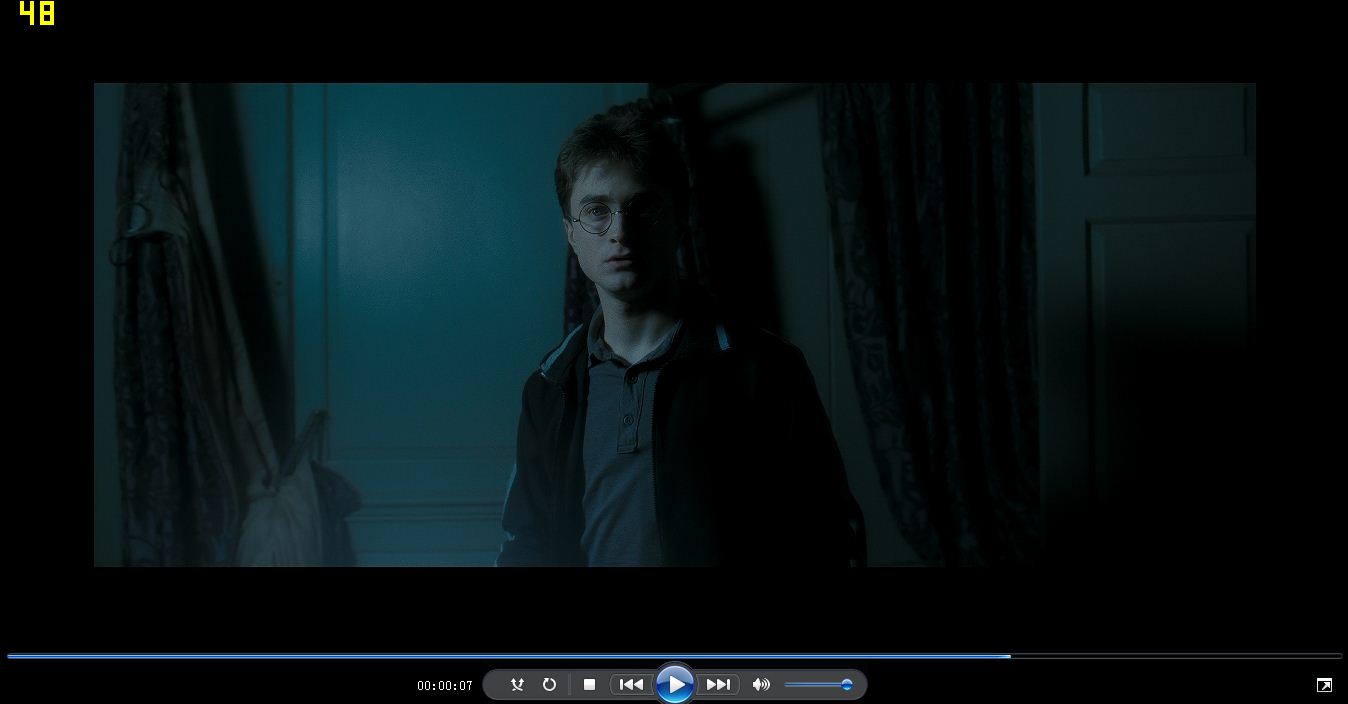

3 (edited by whindson 27-06-2011 01:30:29)
Re: VC-1 movie problem
from fraps 3.2.6,and 48fps@60hz isn't smooth as 60fps.
the attachment is screen shot from potplayer playing vc1 coded video
add info:
Filename: 112.ts
Detected monitor parameters
Screen size and refresh rate: 1366x768 pixels, 60.065 Hz
Video smoothing info
Smooth factor: 5:2
Current detected profile: 1920x1080@23.976
[ExMethod=MSmoothFps_Complex]    Smoothness improvement: Advanced
[ExAlgo=23]            SVP-shader: 23. Complex
[ExMulti=5:2:1mm1m]        Framerate change: 24->60 1m (2.5x)
[ExMiniCount=1:1]        Interpolated frames size: Full size
[ExRad=2p]            Search radius: 2 pixels
[ExSearch=4]            Search type: Hexagon
[ExPel=1]            Motion estimation accuracy: To pixel
[ExRecalc=0]            Recalculation of vectors: Do not recalculate
[ExBlockSize=16x16]        Blocks size: 16x16 pixels
[ExOverlap=0]            Blocks overlapping: No overlap
[ExMl=80]            Contour artifacts suppression: Normal
[ExSadml=20]            Bad areas artifacts suppression: Above normal
[ExSadgamma=1]            Bad areas artifacts mask: Normal
[ExBlend=false]            Processing of scene change: Frame repeating
[ExDwnResize=0]            Reduce resolution: Do not reduce
[ExConvertFps=false]        Frame blending to screen refresh-rate:false
Settings by menu
[ExTreads=8]            Number of threads: 8
[Borderlight=0]            Light at black borders: false
[ExStretch=0]            Frame stretch: Do not stretch
[ExCrop=-1]            Cropping: Do not crop
[StopSmoothDelayOnRewind=0]    Smooth on rewind: Turn off and on quickly
http://www.svp-team.com/forum/misc.php?item=346&download=0

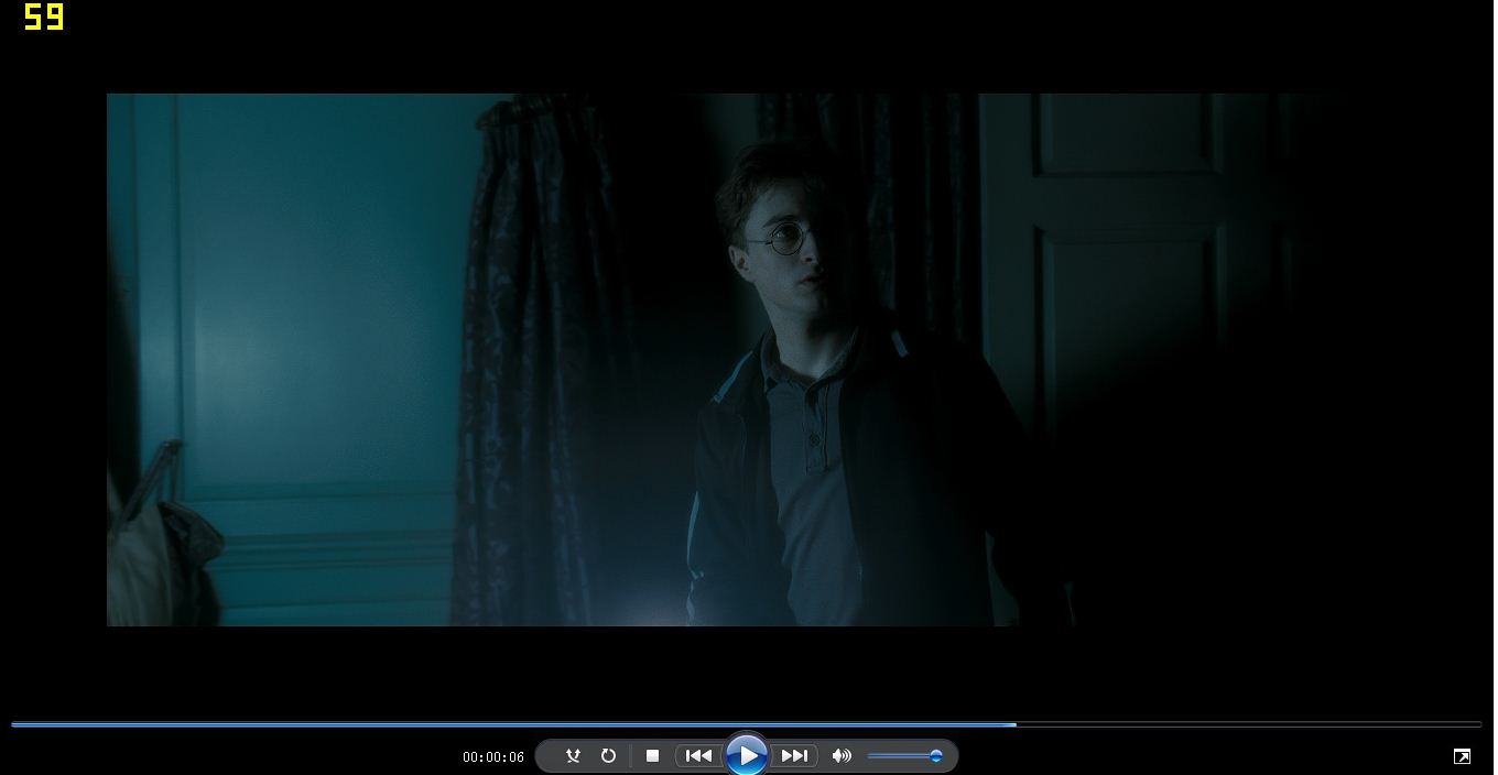

4 (edited by whindson 27-06-2011 01:29:32)
here is the 3x result and the attachment shows 60fps:
Filename: 112.ts
Smooth factor: 3:1
Resulting video frame rate: 71.928 fps
[ExMulti=3:1:3]            Framerate change: Triple the frame rate (3x)
Settings by menu
http://www.svp-team.com/forum/misc.php?item=347&download=0
