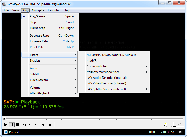

Be patient. It works good.
1. Uninstall external LAV Filters: in the LAV folder run 3 batch files uninstall_*
2. Enable internal LAV in MPC-HC for all formats: menu View - Options - Internal Filters - check all options In Source Filters and Transform Filters sections
3. Check if ffdShow raw is still present as external filter: menu View - Options - External Filters - checked ffdShow raw line with Prefer option
http://www.svp-team.com/forum/misc.php?item=2997

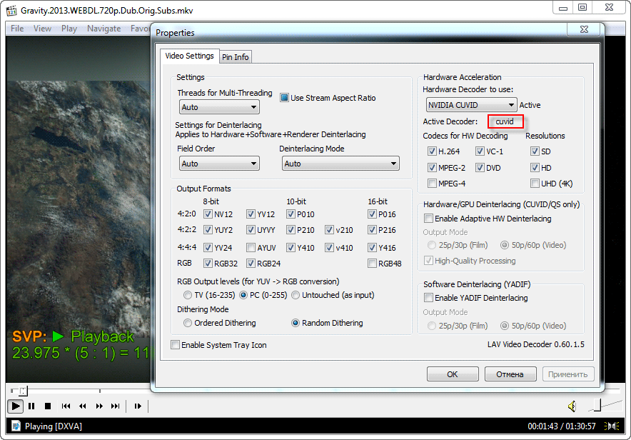

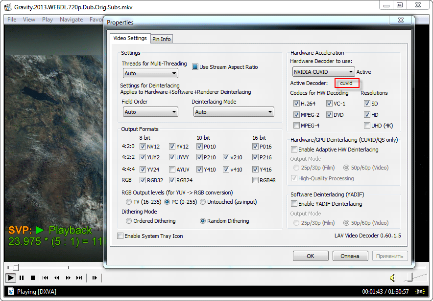

DXVA string at bottom is a normal for CUVID hardware decoder with SVP processing

MPC-HC_with_internal_LAV.png, 16.39 kb, 717 x 527

MPC-HC_with_internal_LAV_CUVID.png, 104.41 kb, 884 x 616

ahhh thanks a lot man! as usual! I get better support here than the Doom9 forums which are meant for codecs/players. they are hostile over there
