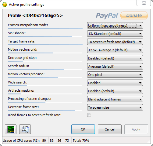

So. I can play 4K video at my Core i5-3570K + GTX 660 Ti. I use MPC-HC instead of JRiver.
Setup order:
1. Check 4K option in LAV Decoder to enable hardware acceleration.
2. Open 4K video with SVP. When SVP icon becomes green then pause.
3. Add new profile: SVP tray menu - Video profiles - Add - 3840 x 2160 x 25 - Save.
4. Open active profile window: double click on SVP tray icon.
5. Change parameters to these and click OK:
http://www.svp-team.com/forum/misc.php?item=2971
4K_profile.png, 14.04 kb, 502 x 481

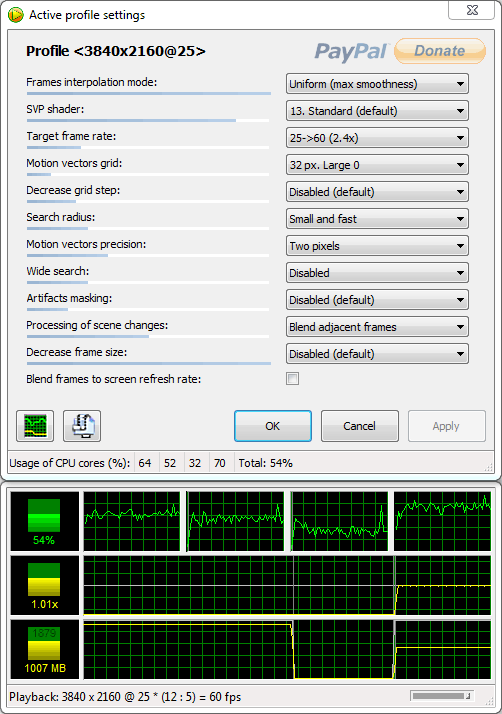

Re: JRiver chashed with SVP and 4K
Decrease frame size: to screen size
big_smile
Oh Sorry! hmm
Chainik is right. I forgot one thing: my monitor size and framesize reducing.
I will change it and find new right settings.
http://www.svp-team.com/forum/misc.php?item=2973
If I choose renderer None then playing is good at 1x speed and 50% CPU usage at minimal SVP settings.
I need some time to understand why all my renders eat 50+% of my CPU power. And how to fix it.
4K_profile2.png, 17.43 kb, 502 x 714
