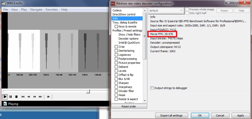

Re: Performance too low on decent system.
SVP is done correctly, no performance issue in your case
Thus "...SVP index=0.85x..." its issue of the videopalyer, or file, or monitor refresh rate is not strong equal 60Hz
please, check the source FPS of the video in ffdshow during playing
It must be equal source FPS 23.976 and dont change during play (it may vary a litle about 23.976 (23.6-24.2fps), but if it vary strong 19-22-26-28fps then its video with variable framerate
http://www.svp-team.com/forum/misc.php?item=2940
www.jpg, 119.83 kb, 997 x 472

The FPS stayed the same as far as I could tell.  What else could it be?
http://i.imgur.com/S9cA56o.jpg
