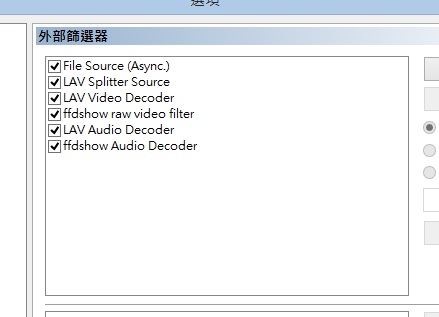

Everytime when i use SVP to play Video with MKV(x264.AVC)
And it's freeze....
If I disable SVP,it will be OK.
This problem is happen after I upgrade my windows.
Now I'm using Windows8.1 x64
At first,restart and reinstall SVP may help me few times.
But now,it's no use.
Sorry for my poor english
NoName.jpg, 24.95 kb, 439 x 317

Re: Some Problems with AVC & x264
calex0901
try to remove:
- file source
- ffd audio
4 (edited by calex0901 17-11-2013 02:28:46)
Thanks for your answer,but it's no use...
Everytimes after I restart the computer.
SVP is work when I forward 5 seconds at the video starts.
But it's only works for few times and "tiny probability",otherwise it's freeze too.
Sorry for my poor english....
I just found the reason.
In madVR settings-rendering-smooth motion.
It cause SVP some problems.
Do not use it.
And then it's all OK...
