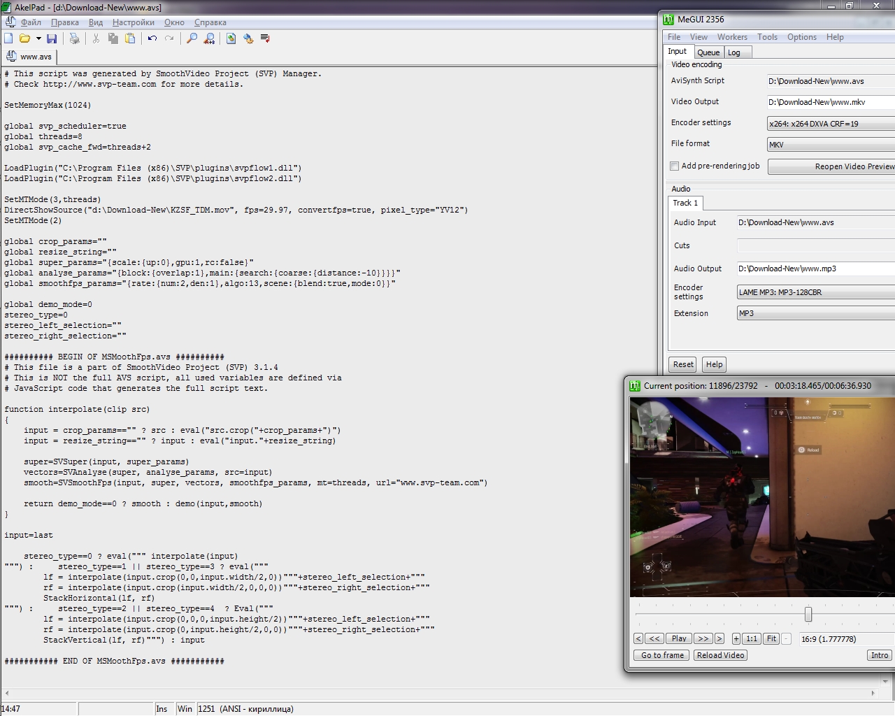

all works
http://www.svp-team.com/forum/misc.php?item=2826
who is videodecoder?

My decoder is ffdshow (it's the only decoder installed along with the SVP package).
I played around with the script some more and was able to run in successfully when I replaced
DirectShowSource("D:\Videos\svp\KZSF_TDM.mov", fps=29.97, convertfps=true, pixel_type="YV12")
with
DirectShowSource("D:\Videos\svp\KZSF_TDM.mov", fps=29.97, convertfps=true).convertToYV12()
So it seems the problem was, that AVS threads the video stream (wrongly) as YV12, because this attribute was hardcoded. Every "convertToYV12()" further in the script was ignored then.
