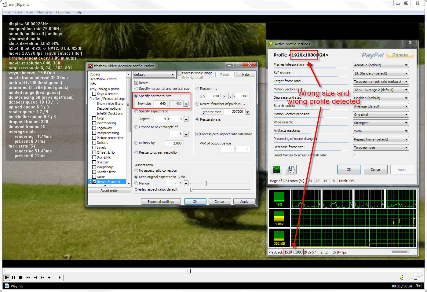

I see some problems with resizing in ffdShow inside MPC-HC. But not such as you described.
It is wrong SVP profile detected while ffdShow resize is enabled. But resize works fine.
http://www.svp-team.com/forum/misc.php?item=2804
