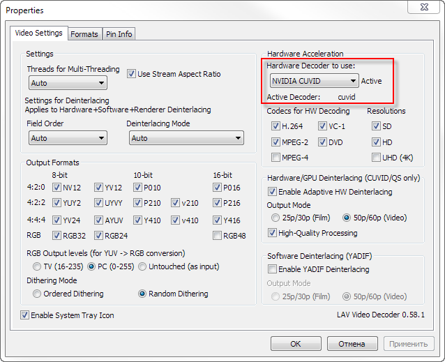

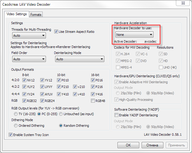

edk1010
Start from reset all profiles: SVP menu - Video profiles - Reset to defaults - (wait for performance autodetect) - OK - Yes
I was wondering where it is I need to check to see if I'm running LAV in software mode
in MPC-HC while playing: menu Play - Filters - LAV Video Decoder
http://www.svp-team.com/forum/misc.php?item=2749  http://www.svp-team.com/forum/misc.php?item=2750
Software mode is named as "None" and "avcodec"
LAV_HW-decoders.png, 22.17 kb, 638 x 519
LAV_Soft-decoder.png, 22.17 kb, 644 x 513
