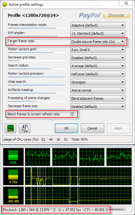

This is the profile for playing 720p:
http://i.imgur.com/RXSaqKS.png
This is for 1080:
http://i.imgur.com/RXlkgD7.png

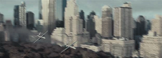

As for the picture problem, I've uploaded a sample video of it.
Please download it and see it for yourself. I don't know the technical term for it  and I don't know if this falls into "interpolation artifacts".

Re: A lot of problems when using SVP for potplayer (watching anime)
Kanade
Thank you for video explanation.
I see. It is so called dragonfly artifacts. Objects in the frame moved by vectors of background. Airplane shakes its wings like a dragonfly. It is kind of interpolation error.
http://www.svp-team.com/forum/misc.php?item=2462
You can decrease amount of dragonfly artifacts by two ways:
1. by changing SVP-shader from 2.Sharp to 13.Standard or to 23.Complicated. In addition it increase smoothness but it decrease sharpness a bit.
2. by enabling Artifacts masking to Average or to Above normal. But it decrease local smoothness a bit.
Dragonfly_artifacts.gif, 197.42 kb, 624 x 225
Thank you for the reply.
After testing various vidoes:
1. Changing SVP shader to standard/complicated: It didn't do anything as the "Drangonfly artifacts" are still there
2. Enabling artifacts masking to average/above normal:
        - For average, it didn't do anything as the effect is still there
        - For above average, it reduced the dragonfly artifacts by a lot however, it didn't completely remove it as I can still see the effect
        - For strongest, the effect is completely gone but there are no smoothness during pan/tilt shots. It's same as watching without SVP.
As a result, from what I can see the best option is to enable artifacts masking to above average however the effect is still visible and it hinders my viewing experience.
Is there any other thing I can try? because the current ones don't seem to remove the drangonfly artifacts completely.
Kanade
There are two causes of dragonfly artifacts:
1. Some objects have wrong vectors (vectors of background). Error of vector search algo. It is because big vectors grid size and small search radius.
2. Some objects have very small or thin size that smaller than grid size. Such objects can not be interpolated correctly by current SVP algo. It is lack of current frame interpolation algo.
Try to decrease Motion vectors grid step from 24 to 16 or to 8.
Try to encrese Search radius.
In simple cases it ill help. But in hard cases SVP will give artifacts on any settings. By now dragonfly artifacts can not be removed completly.
11 (edited by Kanade 04-04-2013 10:46:26)
Thank you for the information about dragonfly artifacts. Now I can understand it better.
Your right, looks like I won't be able to remove the artifacts completely... after trying different combinations, this is the setting I find the best with minimum dragonfly artifacts:
http://i.imgur.com/7g2kR6V.png
It removes the noticeable and big ones but I can still see small texts having dragonfly artifacts.
Is there anything else I can try?? If this is the best we could do, then it can't be helped I guess... but if there is more tweaking I can try to remove dragon fly artifacts completely, then I'm more than happy to try it.
Kanade
1. via SVP only:
http://www.svp-team.com/forum/misc.php?item=2474
2. Intepolating via SVP & blending via madVR:
- in SVP select frame doubling: Double click on icon ehan playing - Target frame rate: Double source frame rate - OK;
- in madVR enable smooth motion: rendering - smooth motion - enable - OK
is there anything else I can try to remove the dragonfly artifacts completely?
You can try to change any settings. All main settings I told you before. You can reduce visibility of artifacts but it is impossible to remove this kind of artifatcs completely.
FrameDoubling_&_ConvertFPS.png, 25.46 kb, 451 x 714
For 1. via SVP only:, I'm getting error message as shown below:
http://i.imgur.com/2ry5HZI.jpg
The message keeps popping up throughout the video.
For 2. Intepolating via SVP & blending via madVR:, I'm not sure if its actually blending it to 60fps:
http://i.imgur.com/wTPiWtY.png
So overall, is it best to use either of these methods to "reduce" the visibility of artifacts? Could you clarify the benefits of using these methods?
Kanade
I'm getting error message as shown...
SVP performance is too low.
Try to lower the profile settings. (SVP Index=0.81x)
Thank you. It was error of SVP-Index calculation. It is fixed.
Just exit SVP Manager, unpack fix to "Program Files\SVP 3.1" folder and run SVP Manager again.
