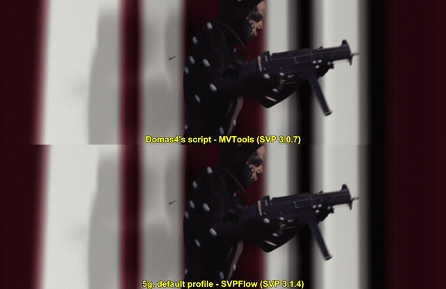

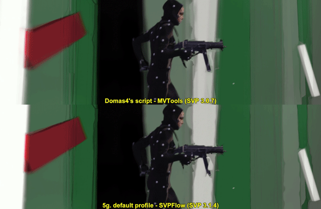

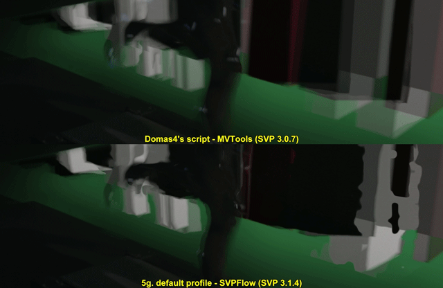

Take a look at these comparisons.
http://www.svp-team.com/forum/misc.php?item=2453
Wave artifacts both at your script and at SVP 3.1.4.
http://www.svp-team.com/forum/misc.php?item=2455
Your script gives more frameblending area, SVP 3.1.4 gives more true interpolation area but more wave artifacts.
http://www.svp-team.com/forum/misc.php?item=2456

compare_1685_1686.gif, 214.76 kb, 640 x 416
compare_2214_2215.gif, 260.96 kb, 640 x 416
compare_2950_2951.gif, 217.86 kb, 640 x 416

MAG79 excellent screenshots. Yes it gives a bit more blending area, so take a look at the bottom picture left corner, you can clearly see the black stripe being waved, which clearly spoils the picture when watching real time. The blending area might be reduced by setting plevel=0 in my script. I tried to do the same blending with SVP 3.14 by setting values same as in Mvtools2, but I could not get rid of those "black" waves. Anyhow, good that you guys are testing. smile Good luck
