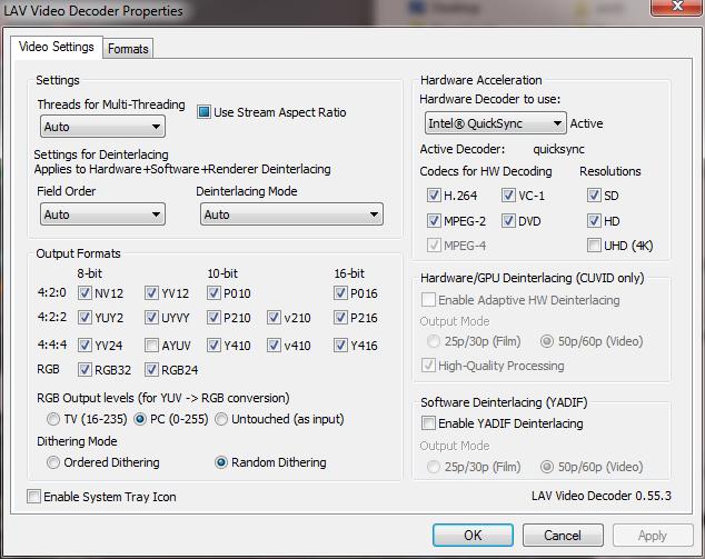

Thanks for replying Chainik.
I've got Radeon HD 6470M on the same machine operating in 'switchable-graphics' - which from my understanding requires me to be plugged in to operate. And I'm not plugged in all the time, hence I went with "Intel Quicksyn" in LAV video decoder options.
Is this where svp manager decides to select which gpu to use? If not, how can I change it to the radeon HD 6470M GPU(and try to reduce frame drops).
Any help would be appreciated.

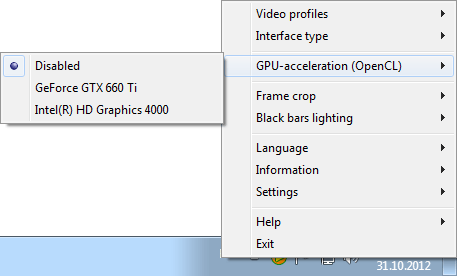

Re: Frame Drops by 100s in FullScreen(exclusive)
RKuken
You can select only 2 jobs for each video adapter you have (Intel HD3000 and AMD HD 6470M):
1. Video decode.
2. Pixel shaders and video scaling.
HD3000 not supports SVP math. When you check option GPU-acceleration in SVP it enables for AMD HD 6470M only.
If SVP can use more than one video adapter then it make available selection by user:
http://www.svp-team.com/forum/misc.php?item=2373
GPU_select.png, 6.62 kb, 457 x 276
MAG79,
I don't have those options. Mine is just checked like this,
http://i49.tinypic.com/2lww27d.jpg
If I change to DXVA2 copyback(which I suppose means use the ATI GPU), the frame drop count isn't lowered and I don't see any difference from when the "LAV Video Decoder" was set to Intel Quicksync.
What else could I try to lower the dropped frames?
RKuken
It is normal. You have only one GPU device compatible to SVP. Option is not appear for such config.
Change renderer from madVR to EVR (or Overlay for testing purpose).
